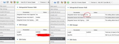

Surface Pro 5 shows 2 seconds logo, then OFF
Flashed Doner board BIOS --> bitts but no touch
Original BIOS (broken, no boot) and DONER BIOS (OK, but no touch) attached.
Cen you help me build a working BIOS please?

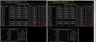

please fix the bios for me stuck on logo
Surface is always like this, the touch will fail when the original BIOS is lost, there is no way to restore itthnak boss is working but touch not workin
clear me will lose touch.please unlock this and clean me
this is the original bios that has lockclear me will lose touch.

Do u sure, meybe only ISHC is turn off when clean / rebuild bios? Someone on other forum write how to back touch functionality. But I'm not sure he was have original bios or use from other machine.Surface is always like this, the touch will fail when the original BIOS is lost, there is no way to restore it
what does it mean ?Do u sure, meybe only ISHC is turn off when clean / rebuild bios? Someone on other forum write how to back touch functionality. But I'm not sure he was have original bios or use from other machine.
