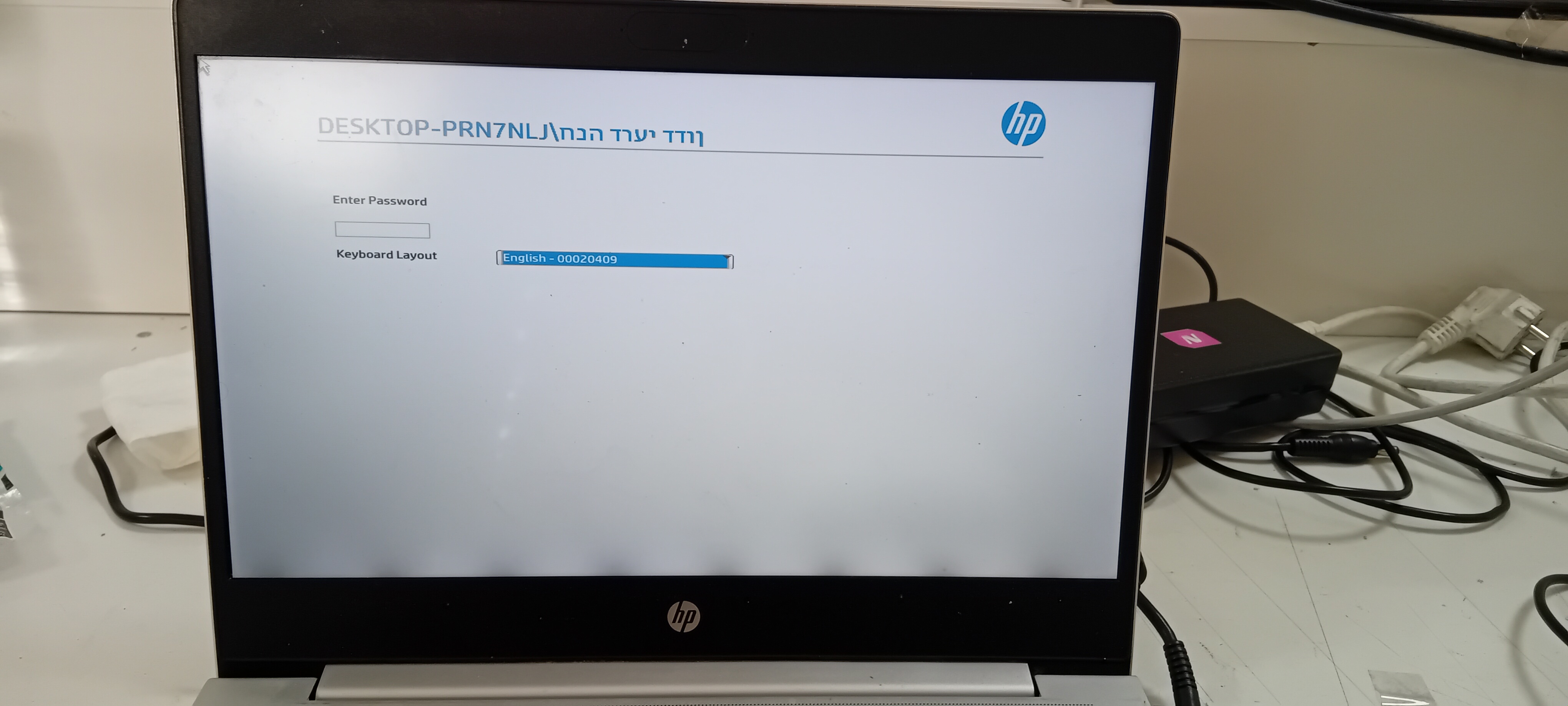

BIOS hp probook 430 g7 430 G6 part number DA0X8LMB8D0 REV D
hp probook 430 g7 part number DA0X8LMB8D0 REV D
BIOS S71
If nothing has changed, the BIOS is original, then the delay problem is not due to the bios
I have already told you many times that with the original bios the PC turns on without delay but gets stuck on the HP logo and restarts in a loop, with another bios the PC turns on with a 40 second delay, so YES the problem is in the bios.
