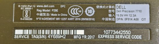

service tag ?
BIOS you send above is Precision 7510
servie tag for model Precision 7710
I'm not sure you provided the correct BIOS
