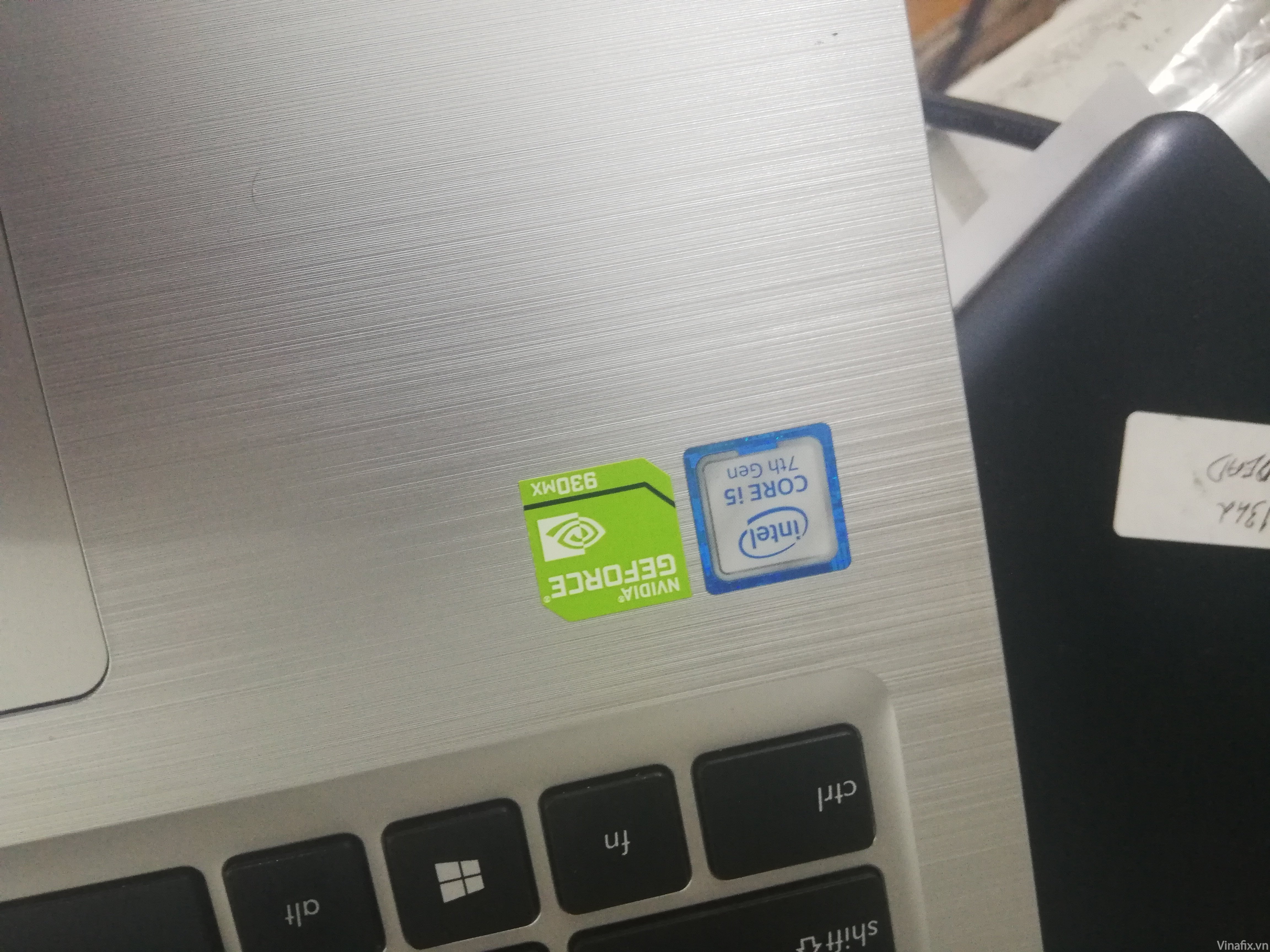

tien buy you are being very stuborn , and this is not a good thing for a nice technician !!! once agin i told you my cpu is a i7 7500 ( so 7TH GEN ) but ok ... photo is now herew .. happy to see that the cpu is 7gen i7 ??? dam mate i work on this for more than 10 years
now with the bios from the first post , mentioning the 7gen bios here is the photo working with triangle on gpu !!
and this is the problem with this vm591u bios . Vbios if unknown !! im going to rebuild this (at least try , its a pain in the ass ,but you to try to get some fix for this )
