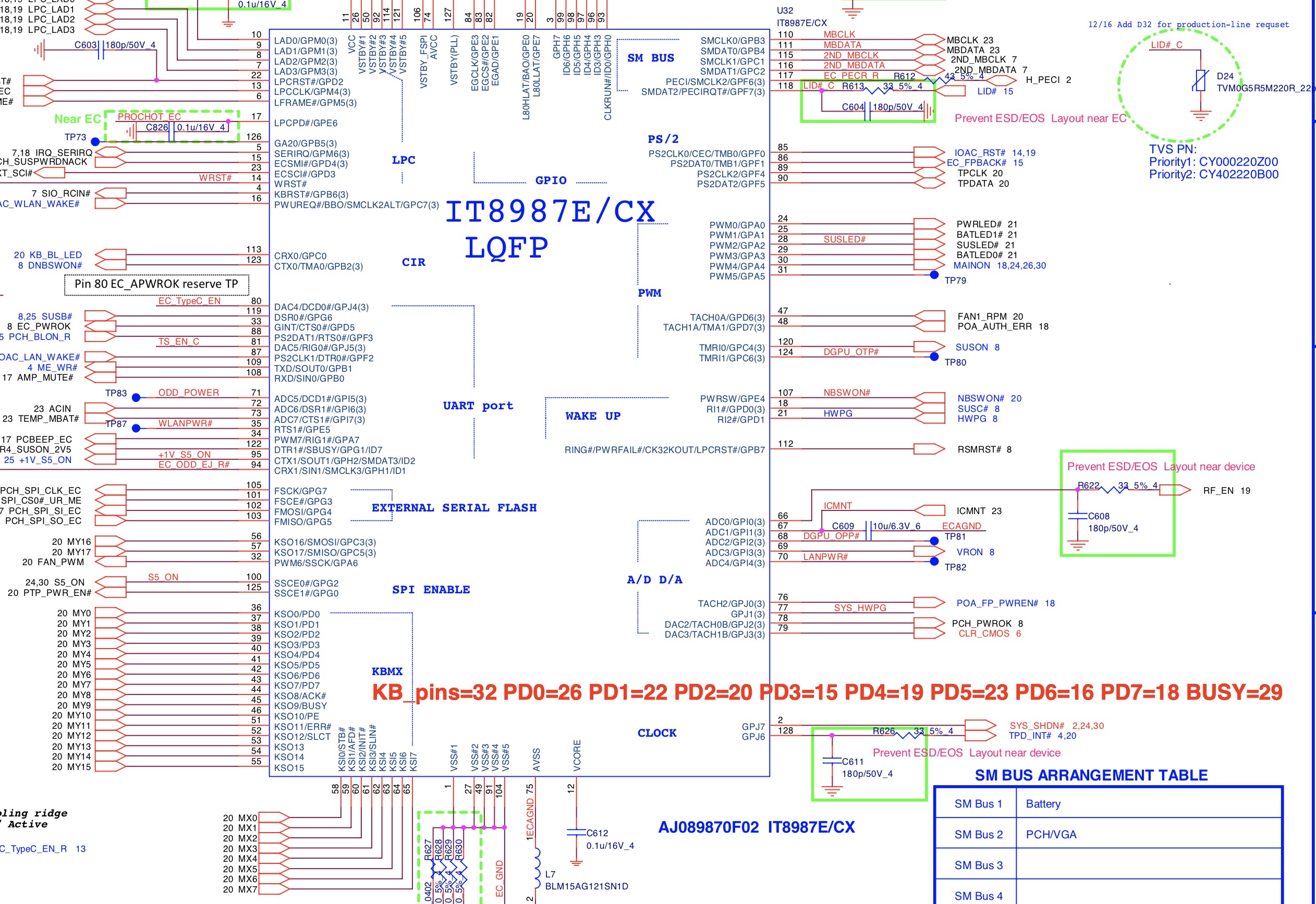

NoteBook=HP_15
BoardNo=DAY11AMB6E0_revE
ChipMark=IT8987E
JKBPins=32
Invert=0
AddBy=Cianyika
KSO0=7
KSO1=11
KSO2=13
KSO3=18
KSO4=14
KSO5=10
KSO6=17
KSO7=15
KSO9=4
KSI0=12
KSI1=1
KSI2=8
KSI3=9
KSI4=5
KSI5=6

KB_pins=32 PD0=26 PD1=22 PD2=20 PD3=15 PD4=19 PD5=23 PD6=16 PD7=18 BUSY=29
