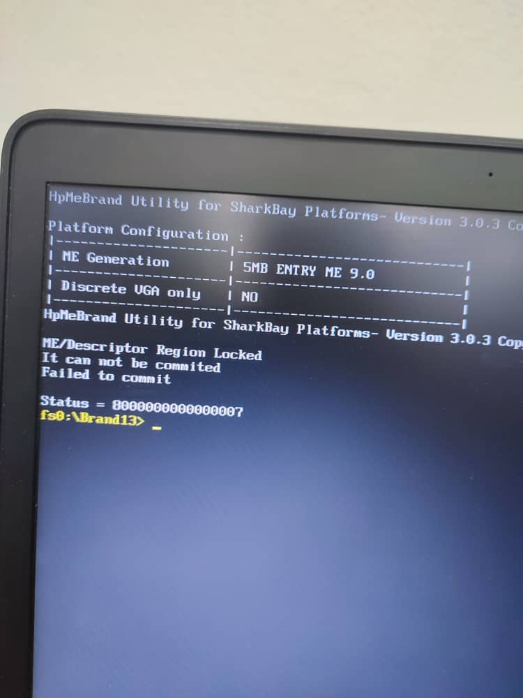

Hi! i changed the cpu of a 450 g2 and needed to make a clear me for the bios. i made the clear me but now it says the machine is not in committed state. i tried all these tools with no success. it says it is not compatible with the platform. i attach the original file, without clear me, if you can help me with a clear me file that doesn't make the machine to be in not committed state. thank you!

I have an HP ProBook 640g1 after flash bios with Clear Me it shows a "Warning machine is not in a committed state", when I try to use brand13 it shows this message.
Try this file
