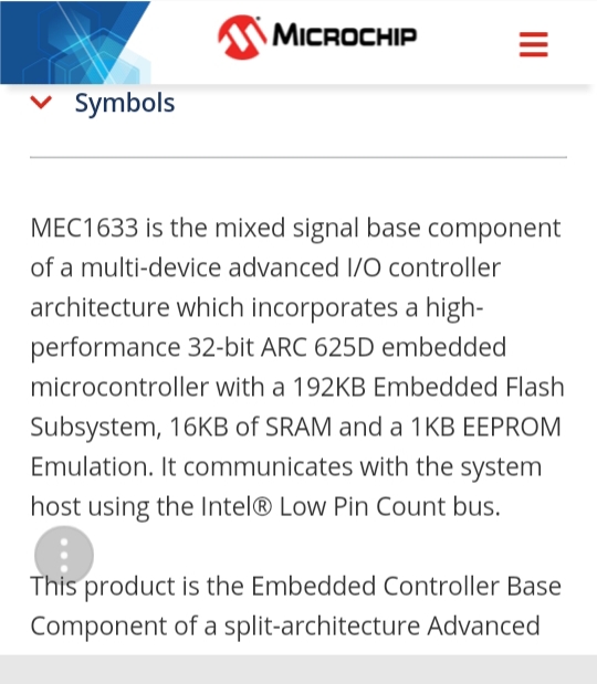

My laptop mec file is 192kb
But you're file is 256kb
Which on is right?
Please help me
192kb because you backed up incorrectly
Can you check if what I say is correct?
please empty the chip and reprogram the 192kb file you just backed up to see if the laptop is working or not?
You'll know if I'm right or wrong
