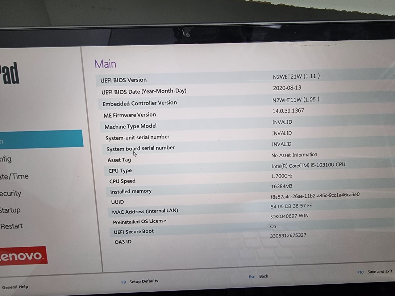

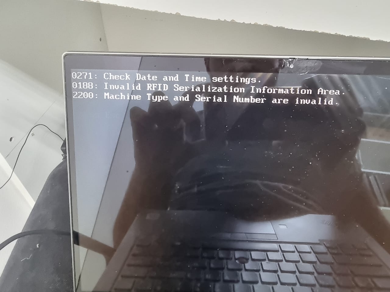

hello
i have problem when device start logo windows is stuck
can you help me please
nm-c881 gen 5 10th
old 2.BIN
Hi, it works with builids7, but when the ntb is left off overnight, the same problem occurs again, after pressing the power button, the power button with the keyboard flashes for a while and turns off
