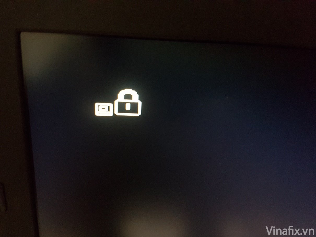

But previously I understood the PWD is in the KBC chip and not in bios
Or am I wrong?
What has been corrected earlier?Code:
0183: Bad CRC of Security Settings in EFI Variable.
Enter ThinkPad Setup. — The checksum of the Security
settings in the EFI Variable is not correct
Solution:
Enter ThinkPad Setup to correct Security settings in
the EFI Variable.
returm old and send i one photo display request password, and provided both bios old.Hello
Sorry what do you mean?
Only thing done to the laptop was KBC chip flashed with this post rom, and BIOS with the BIN file you sent.
Password still there, and this error message Bad CRC
try itView attachment 89098
Here are both original files, BIOS and KBC
And I can see that the picture of the PWD before had a user symbol, and now it has a computer symbol
