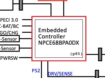

What does i7 have to do with ec?
I have here 2 motherboards, one is i5 and have bios chip on location u2101, model winbond 25r256jven and other is i7 and have bios chip location u2101 model mx77l256sqfz and other chip near I/O, location u2104 model chip is w25q128jvpq.
i have lenovo L14 Gen2 with password i have create a new fiel from lenovo exe for io nuvoton after flash its still on password
old ec file attached serial also
serial : PF-31VT8H
EC Lenovo L14.bin
serial : PF-31VT8H
You need to backup a 2kb file and buy a $45 patch
It's on the same EC chip, but when you go into the programming tool, it will tell you that you're adding a 2kb file
i dont understand according to the schematic there is a spi flash near NPCE6xx is 1mb shows and in diagrame 8k EEPROM
