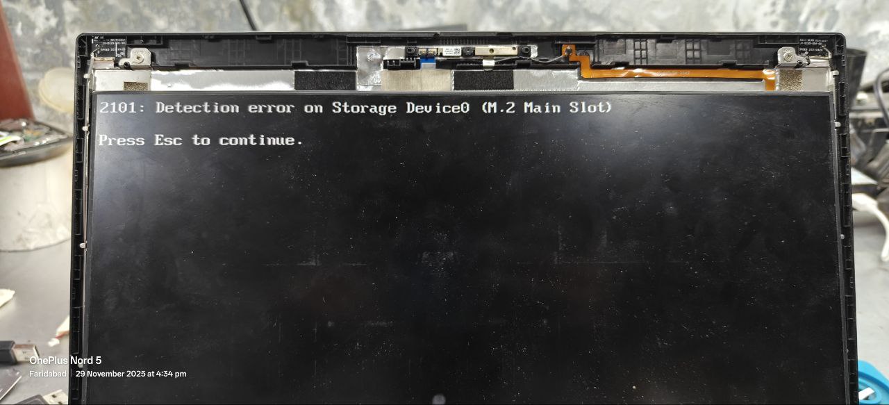

I have a problem with a Lenovo L15 Gen 2 NM-D271 motherboard with an Intel CPU
The embedded controller on the device was defective. After replacing it, the device starts up but displays an error message:
“2203 System configuration is invalid”
and
“2101 Detection error on Storage Device0 (M2.0) Main Slot)”.
There is no information about the ME firmware version in the BIOS.
Can you please help me?
and
