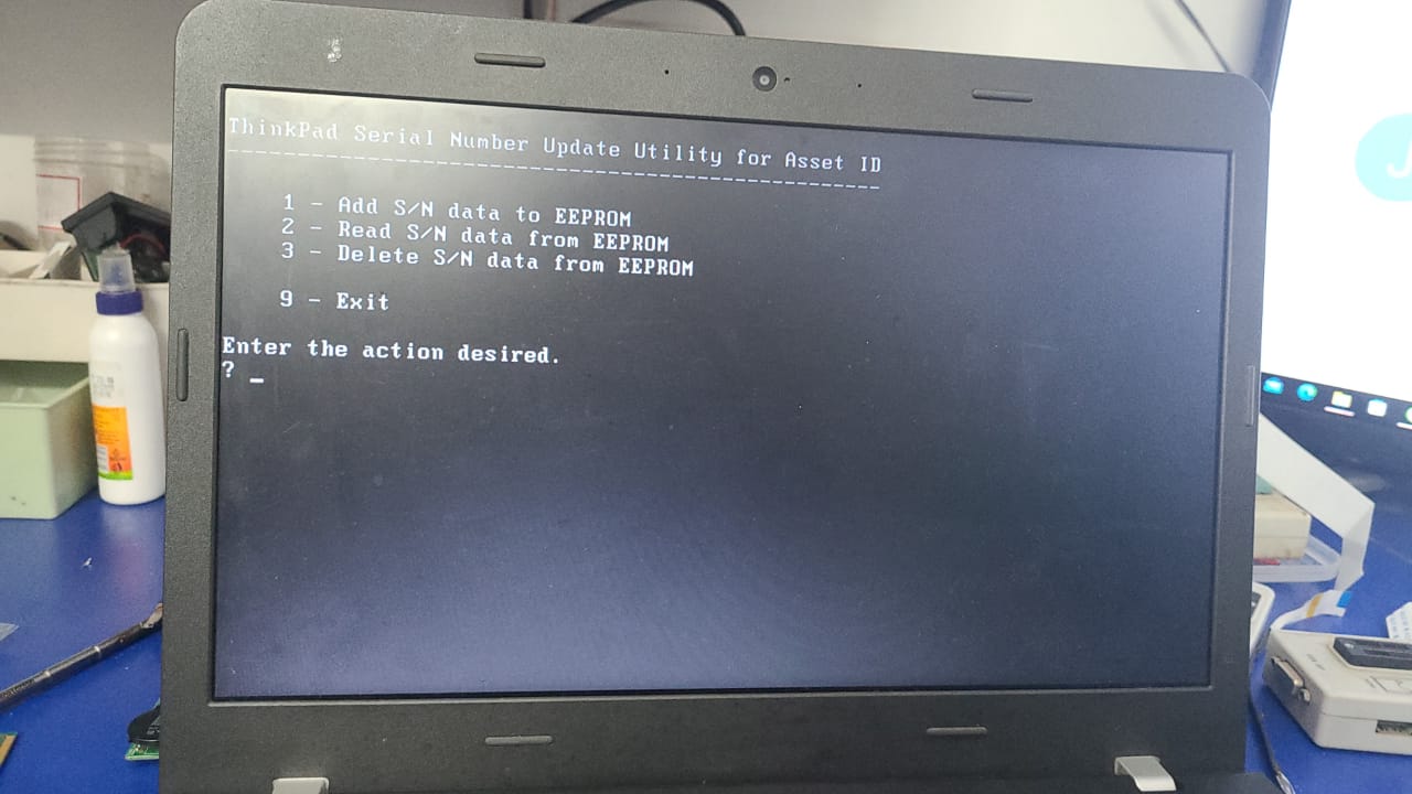

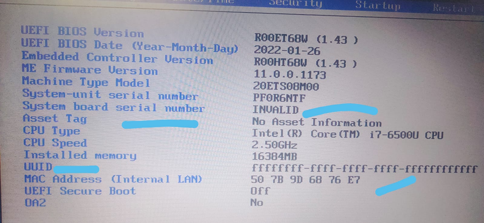

Admin every thing ok i can't solve system board serial number
inside the bios invalid
please clear this error admin
yes i try but can't write
please send me
sio ite8586
that's the problem Lenovo is so it will burn the DMI when programming the SIO
try tool this
there will be no other way
try tool this
admin i can't write system board serial number this one error
