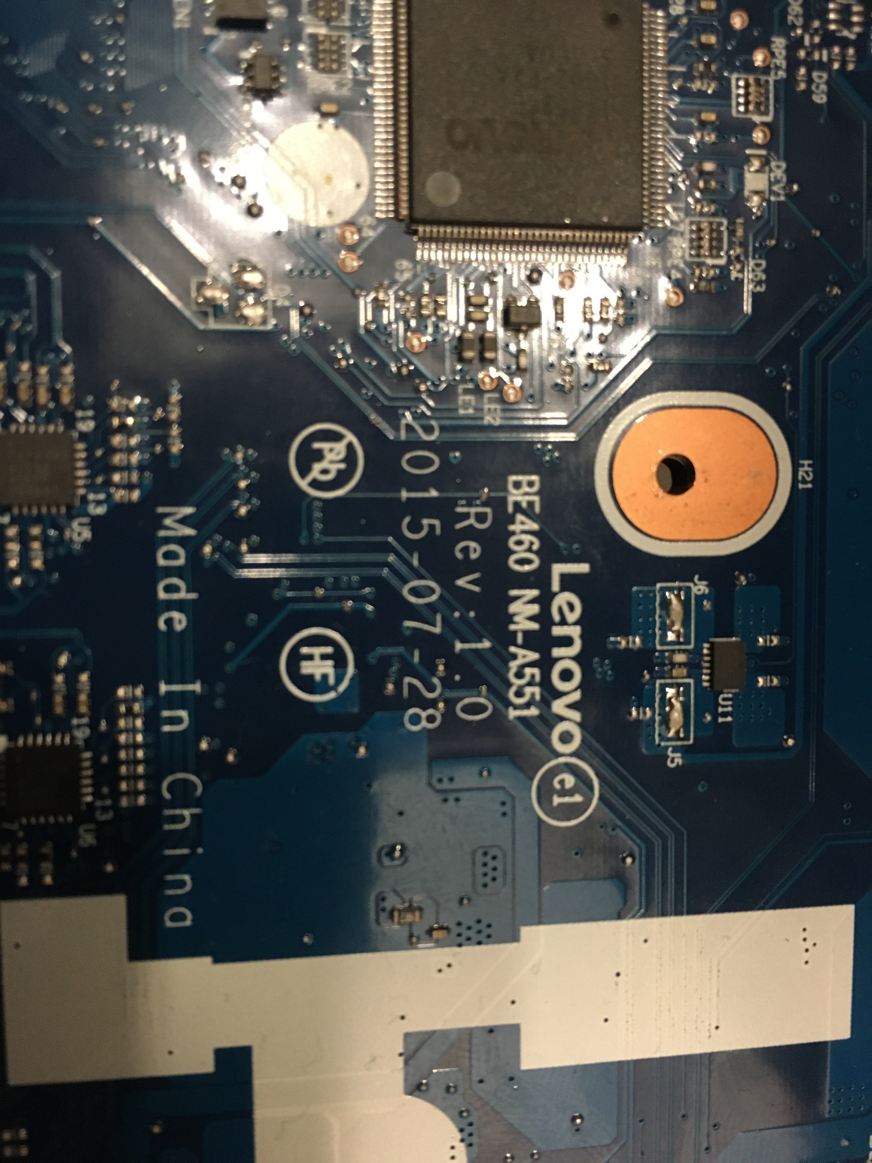

Lenovo E460 BE460 NM-A551 rev 1.0
boardview Lenovo E460 - NM-A551 Boardview (.CAD).cad
NM-A551 Rev 1.0 LCFC Lenovo E460_ BE460 BoardView PDF

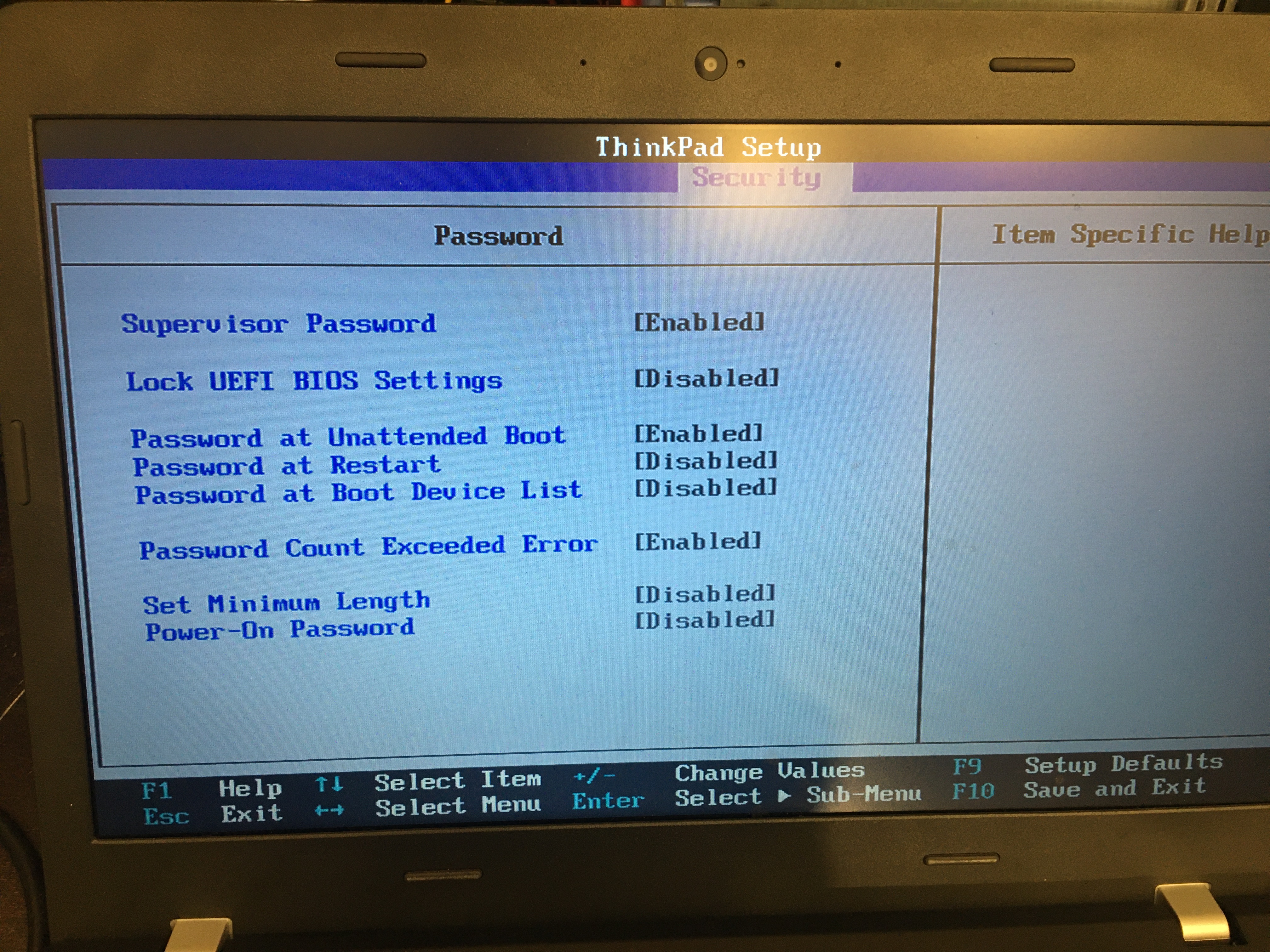

Does it require a password to access Windows?
no care Enabled or disable
Access to Windows i have, windows no have password, but bios menu apps disabled, and i can't select boot settings and change values, date settings and same...
Next you need to program IO ITE

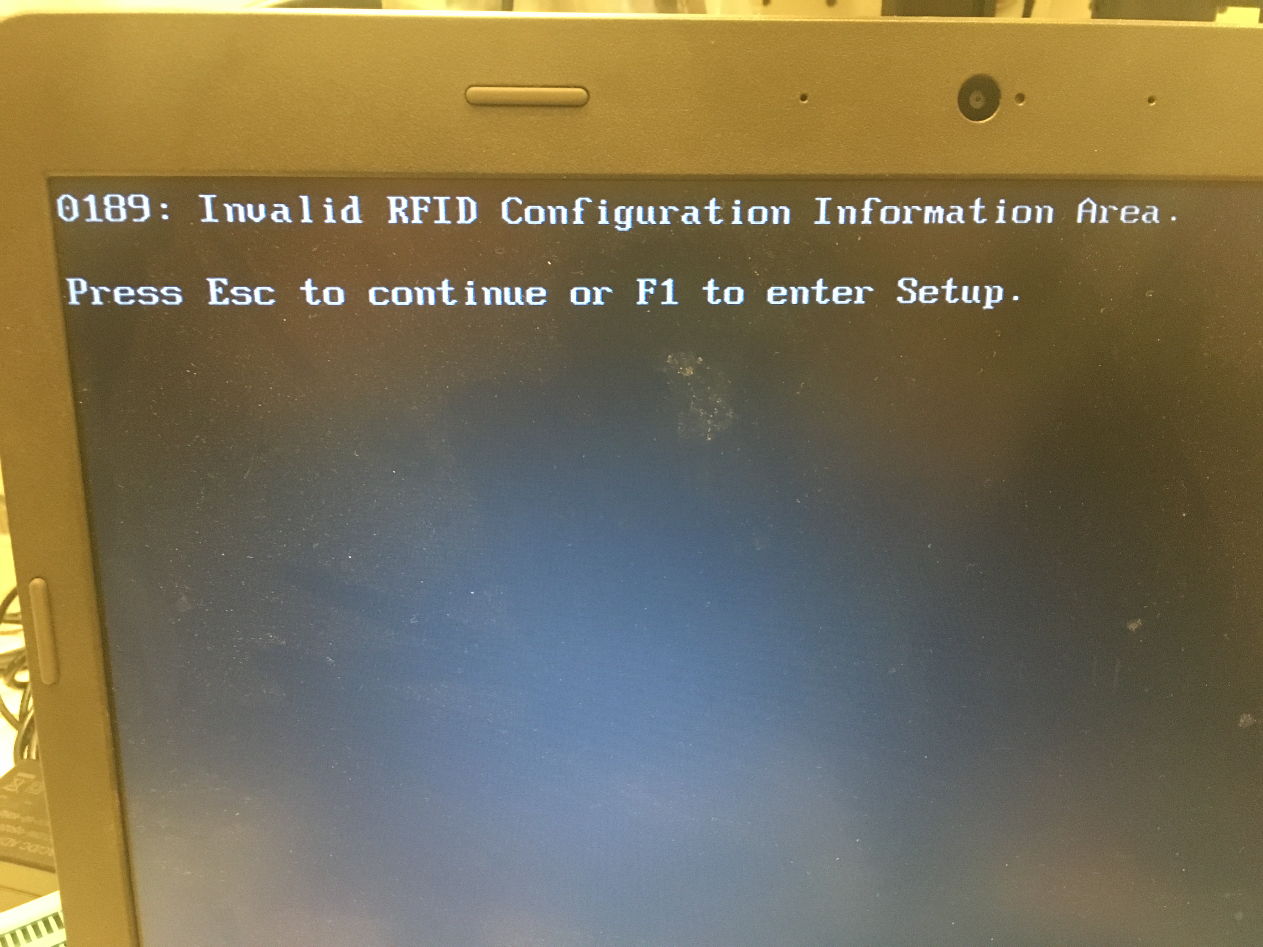

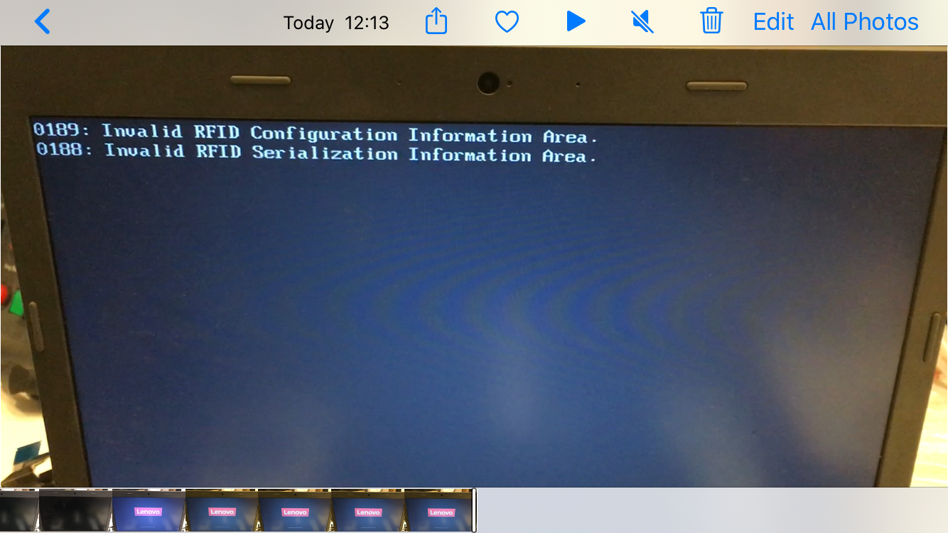

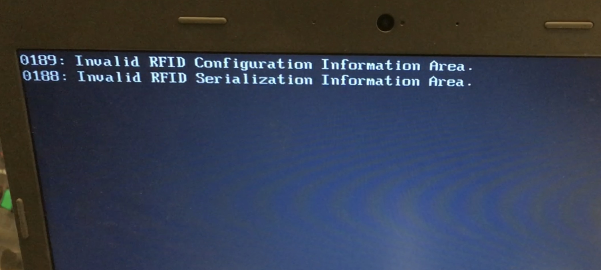

Hi, now i write IO ITE with program from your website, and my laptop show error message "Invalid RFID configuration information area" and "Invalid RFID Serialization information area" . I attach photo with error, and attach old my IO read bin. Can clean my old bin? problem this bin is locked bios apps.

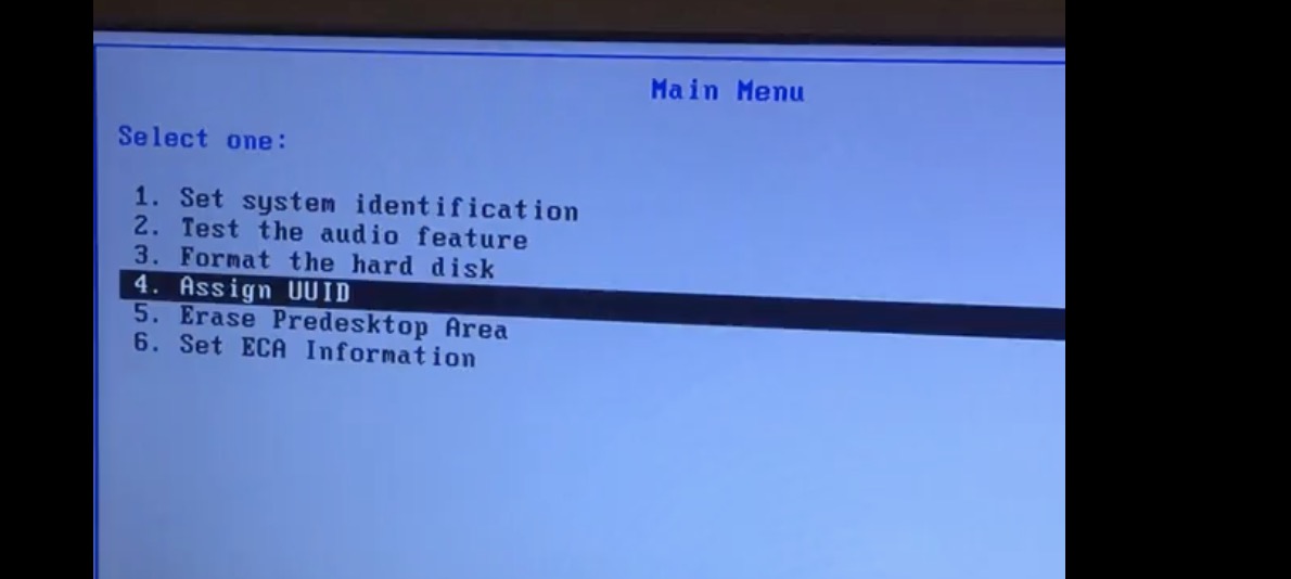

use tool this

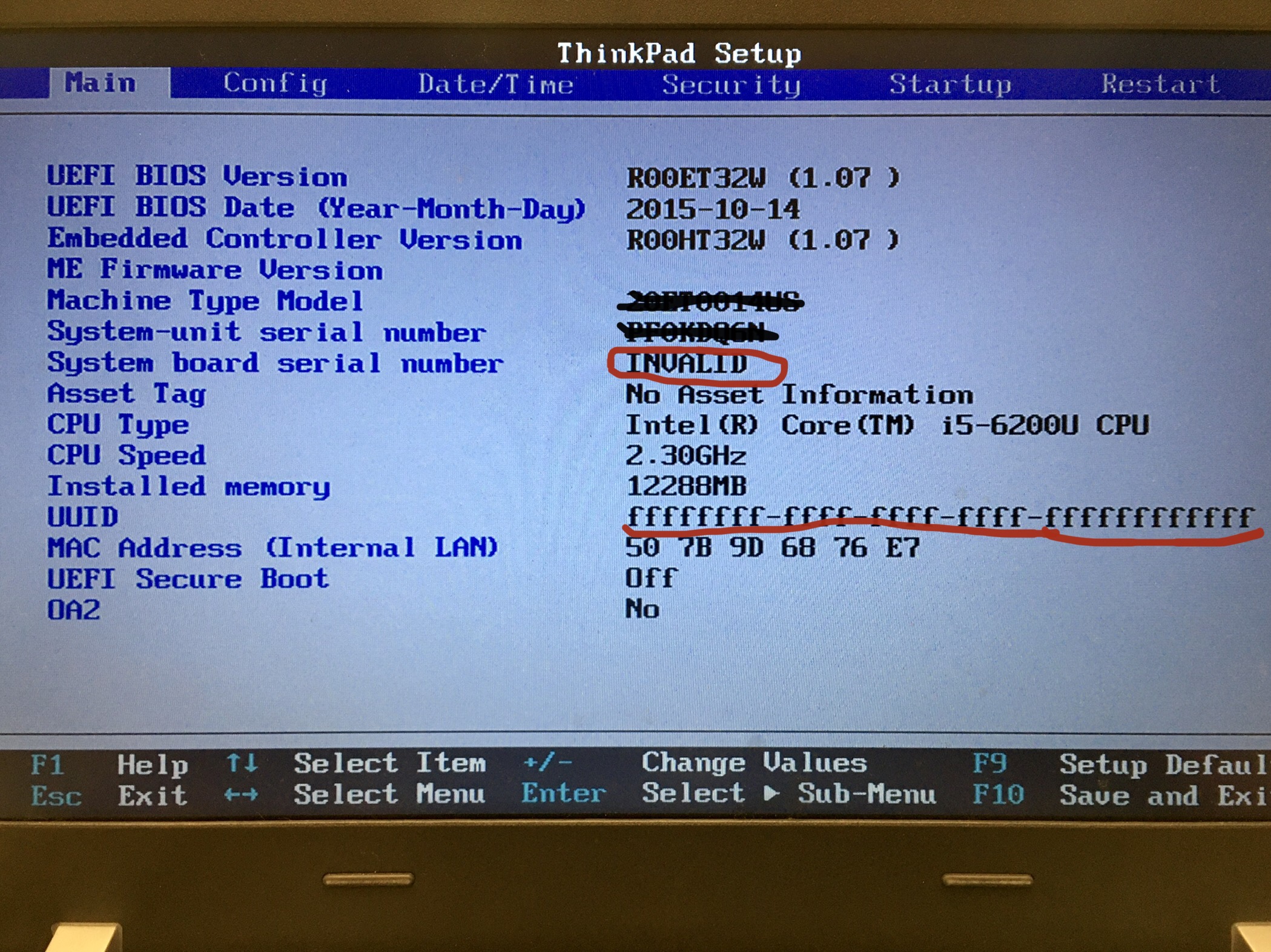

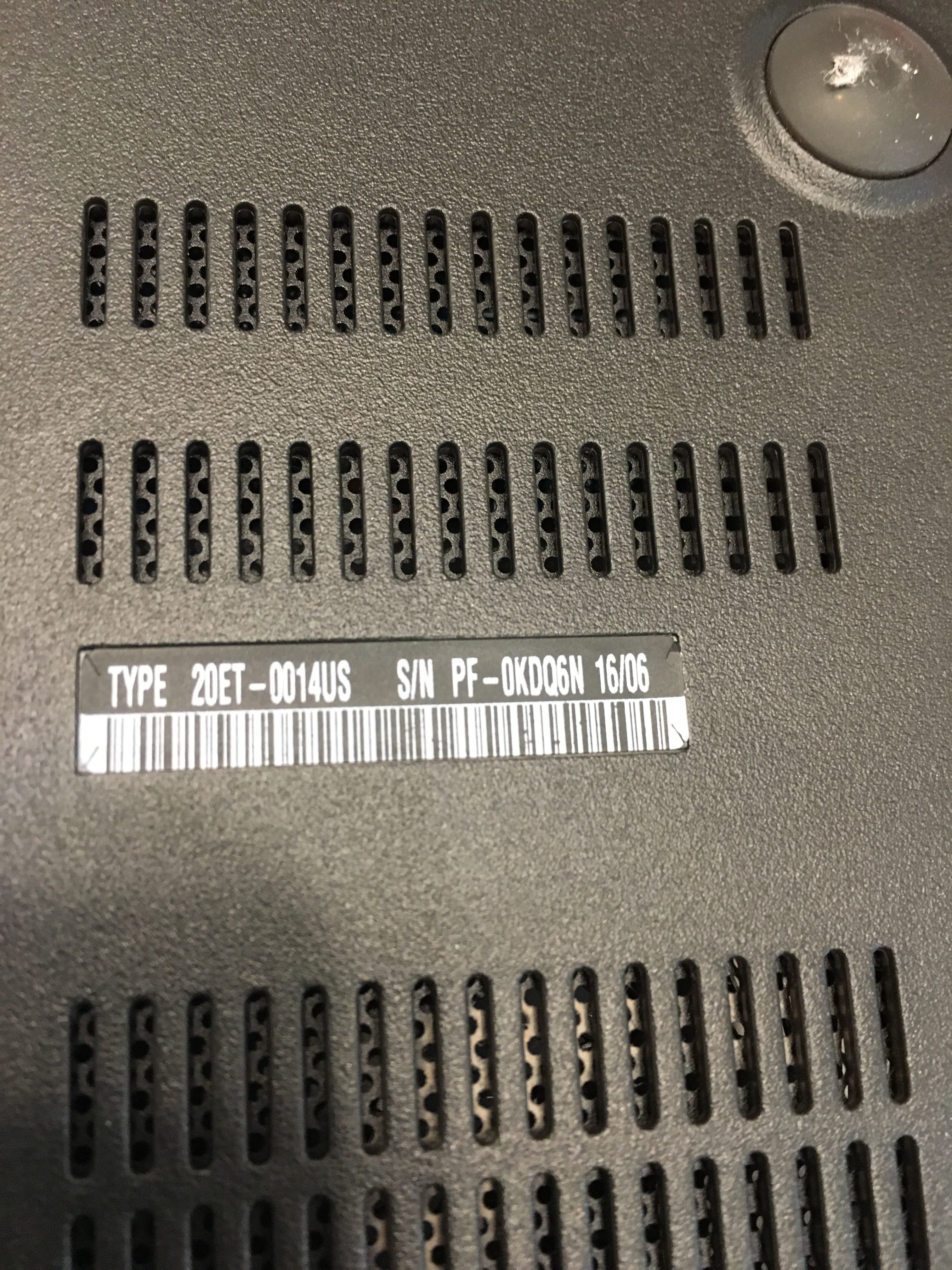

Thanks, i write machine type model, and system serial number, but i can't edit system board serial numeber is INVALID, and,UUID is ffffffffffff-ffffff-ffffffffffff too.
Yes, This is not an easy job, can you tell me why an ITE is needed?
i no see UUID
Please make one video you use tool this add UUID i check
i no see UUID
i no see UUID
