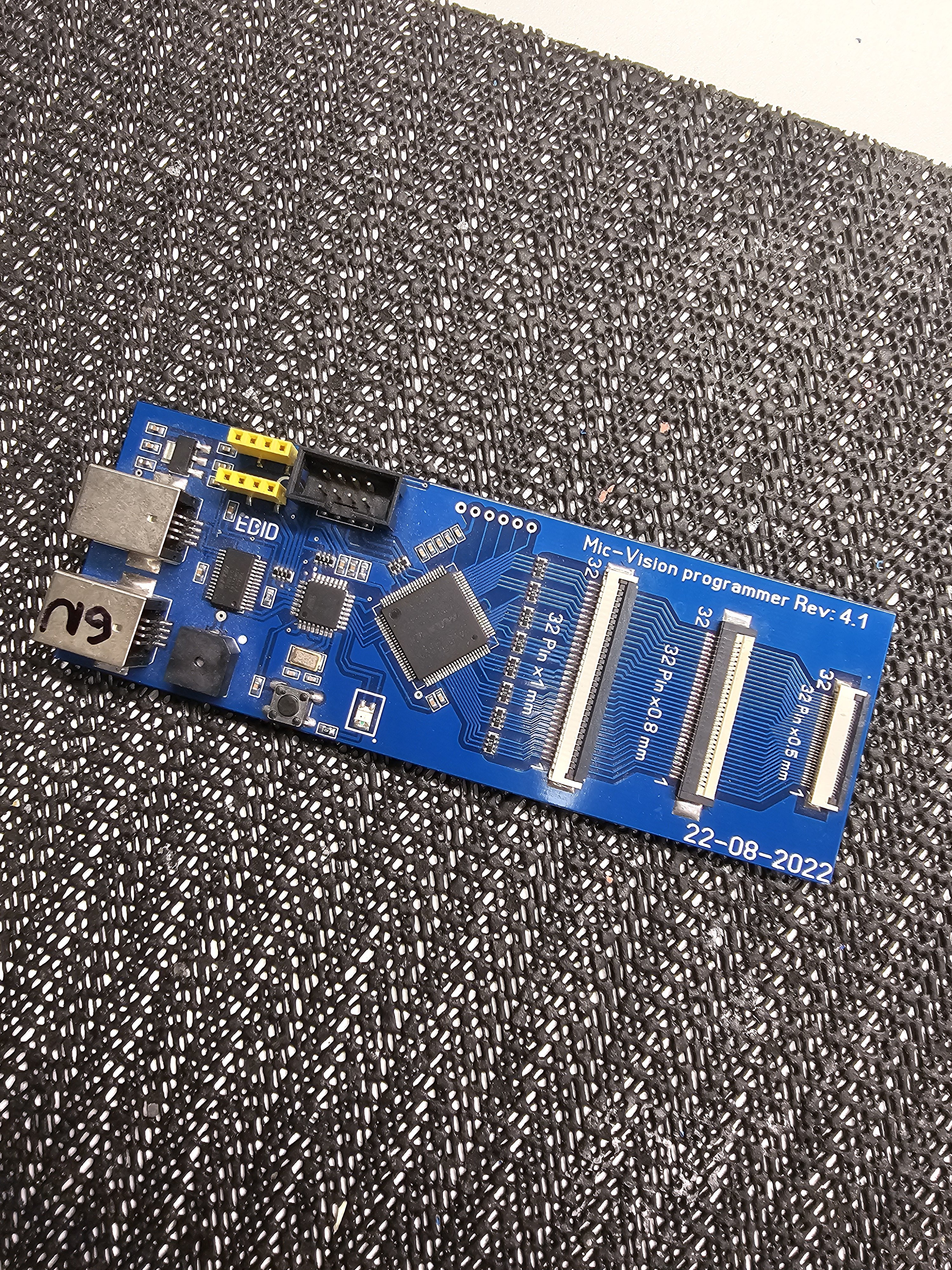

Hey sir,
can you give me pins config for programming io?
MB: NM-D562 Rev 3.0
I/O: IT8227E-256
Thanks.
KB_pins=32 FLASH=128 LEFT DOWN 08MM PD0=13 PD1=17 PD2=19 PD3=24 PD4=20 PD5=16 PD6=23 PD7=21 BUSY=10 STB=18 AFD=7 INIT=14 SLIN=15 KSI4=11 KSI5=12 IT8227E-128
WHERE'S THE 56KB FILE FOR EC ?
ITS not first time you mention EC file for does board with a IT8176FN its the 128kb file or 192 kbs file, does board when you flash EC you flash this file instead of the regular ITE .. so flashing the 192KB file via keyboard line wont change anything and also will make machine not turning on , or multiple hardware failure !
so my question is can you get (UI22) EC file 56kb ??? thk in advance
