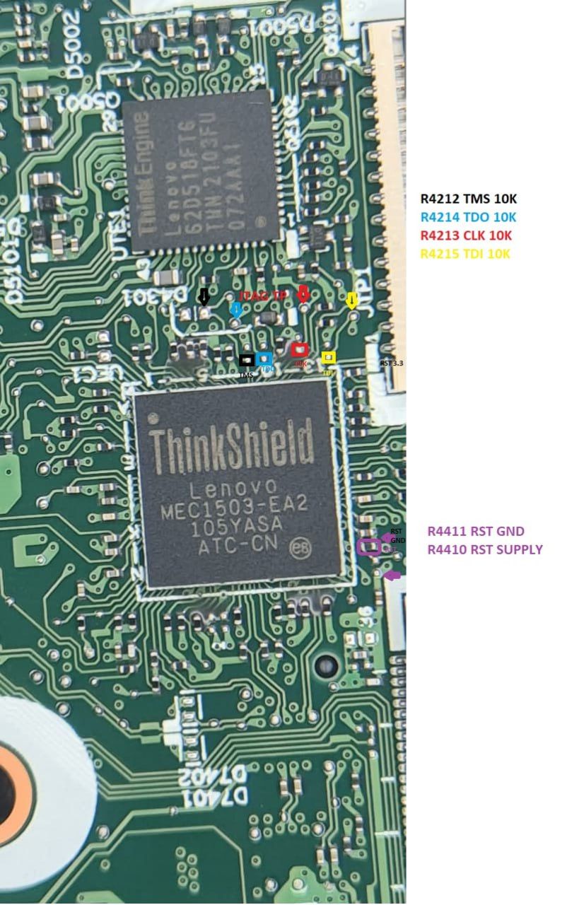

MEC connect Programming JTAG
Carbon X1.jpg.zip
NM-A091 MEC1633L JTAG point.jpg.zip
NM-A102.jpg.zip
NM-A131 MEC1633L Jtag Interface.zip
MEC1621 MBX-256
MBX-237
MBX-237
MEC1609
MEC1619
MEC1621 MBX-256
MEC1621 MBX-256.zip
MEC1619.zip
MBX-237 JTAG.jpg.zip
MBX-259.jpg.zip
LDB-2 MEC1619L.jpg.zip
NM-A131P.jpg.zip
NM-A102.jpg.zip
Carbon X1.jpg.zip

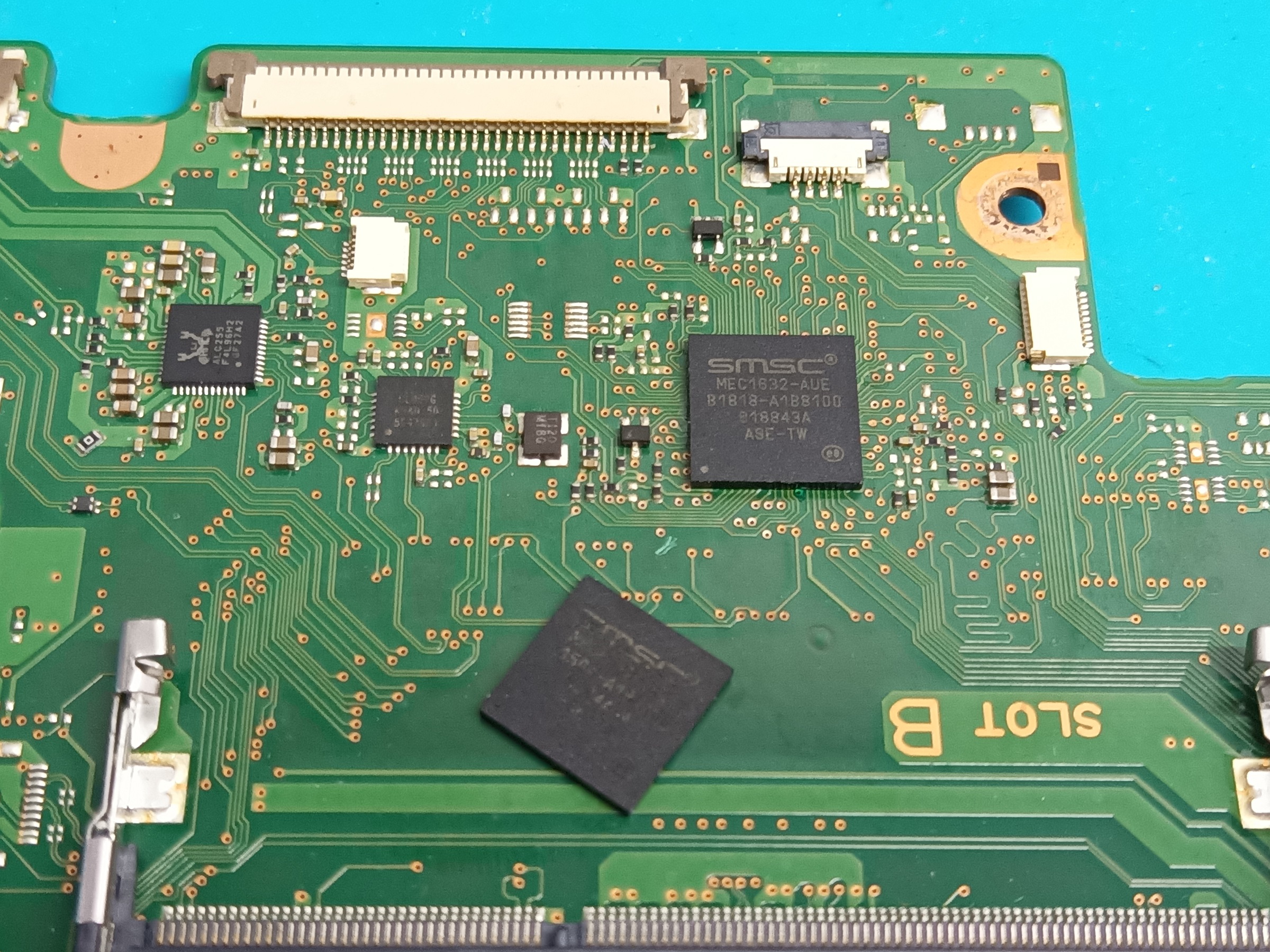

Hello.
Any ideas how to program the MEC1632-AUE ?
The MEC was replaced,
but it doesn't Power ON, there is 3v in the power switch
