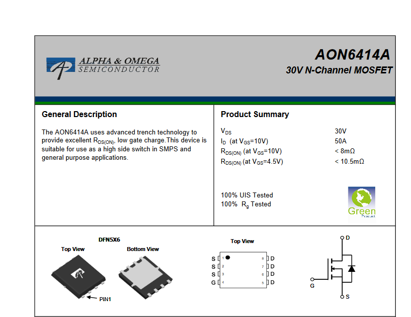

Here is a picture of the top right corner of the main PCB where the power connector JP23 from the external adapter is located:
Here is a close up of those smaller chips to the left of the power connector:
The markings on them are:
PQ5:
"7411 GV511C"
PQ6:
"7752 GA6D2A"
PQ11:
"7405 BA6B12"
PQ13:
"7405 BA6B12"
I can't find any information about these chips, does anyone know what they are?
I'd like to look at the datasheets for them.
If they have something to do with communicating against the power-adapter, then maybe I can look at and set registers in them with the Bus Pirate to force commands to the adapter.
Yes, the logo matches that of Alpha & Omega Semiconductor.
Thanks, they are all mosfets, in that case they are not relevant to my specific situation.
