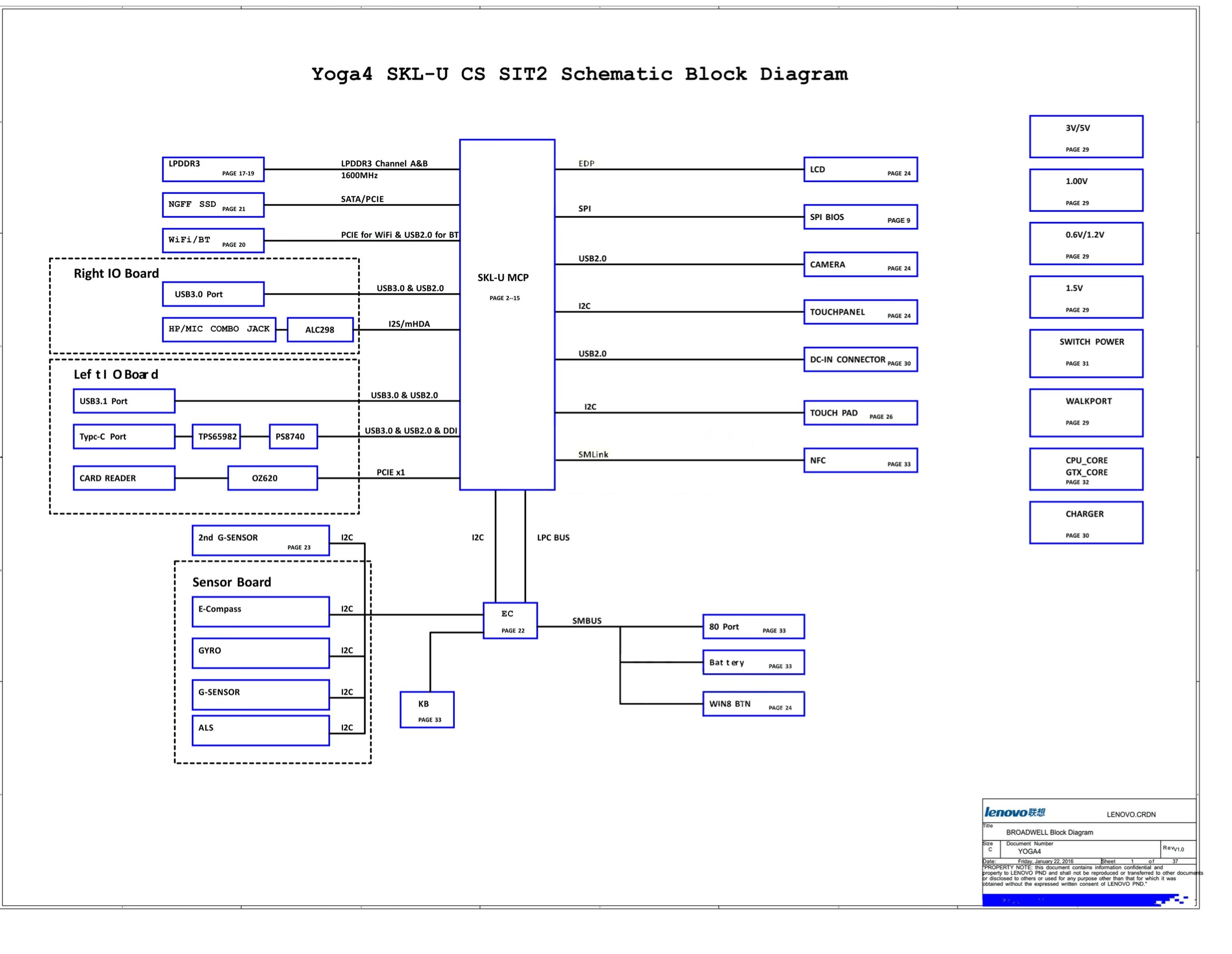

Lenovo Yoga 900-13ISK LCFC NM-A921 Schematics

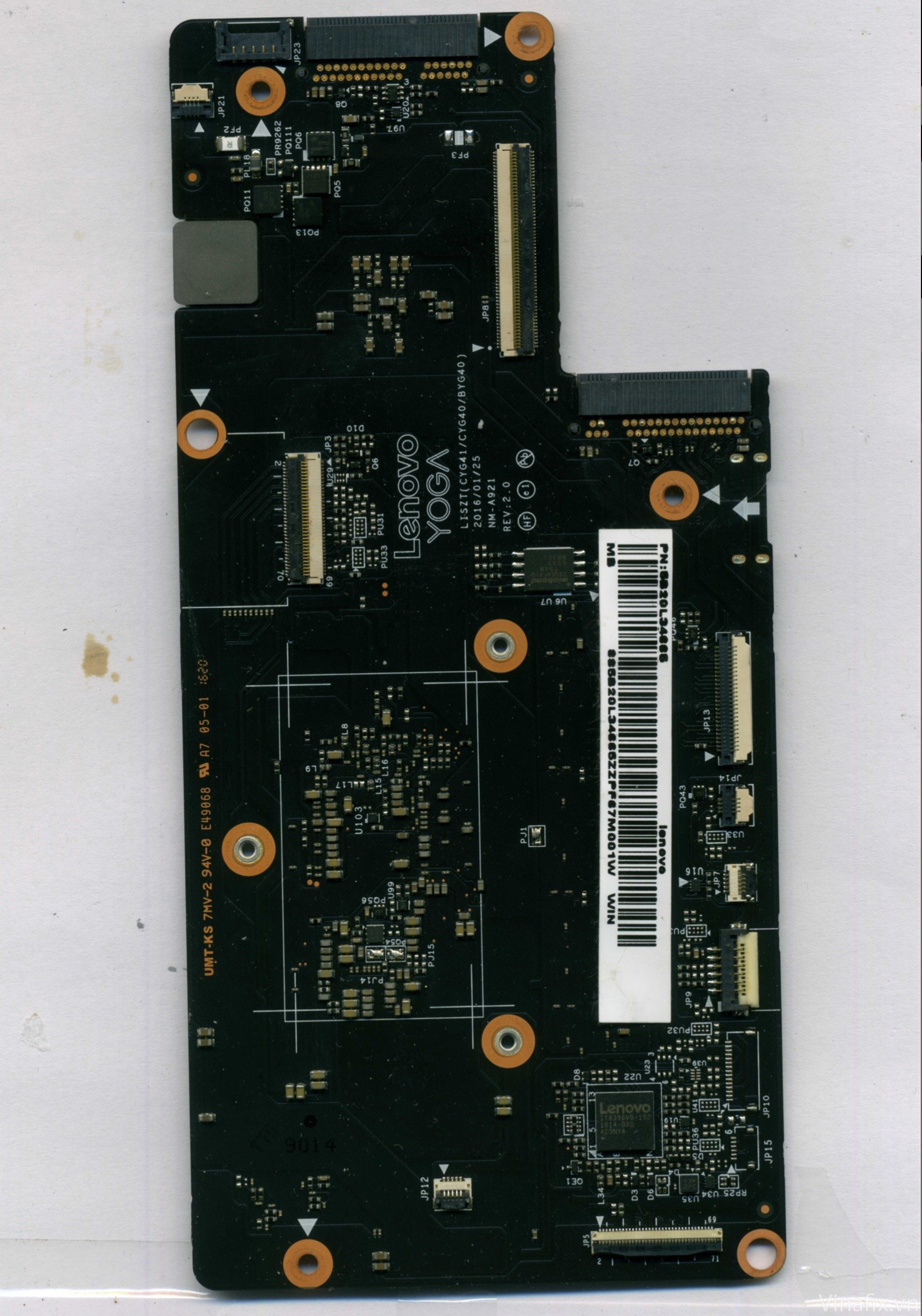

Lenovo Yoga 900-13ISK NM-A921 REV2.0 - Does not power on - Support Required
Hey Everyone,
Go a 900-13ISK in for repair. Does no turn on. No Liquid Damage. Main BIOS flashed. Other components don't appear to be faulty.
Daughter Board / I/O Board: BYG40 NS-A411 REV1.0 - It seems to have a programmable chip which might be the issue but 0 idea at the moment.
Cant find any information this anywhere. Any one experience this yet?
