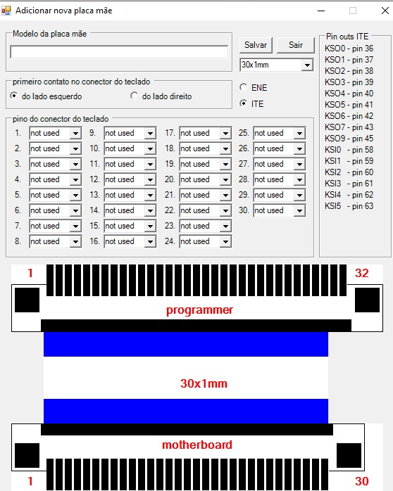

Hello, can someone provide me the pinout config for the it8226e-128 so i can program the EC in svod...
it hasn´t the board in their online database. i must config it manualy.
: ) thanks
: ) thanks
KB_pins=30 PD0=7 PD1=11 PD2=13 PD3=18 PD4=14 PD5=10 PD6=17 PD7=15 BUSY=4 STB=12 AFD=1 INIT=8 SLIN=9 KSI4=5 KSI5=6
Hello again, i dont see ( PD0=7 PD1=11 PD2=13 PD3=18 PD4=14 PD5=10 PD6=17 PD7=15 BUSY=4 STB=12 AFD=1 INIT=8 SLIN=9 ) as you can see in the image .
Can you help?
Thanks ; )
