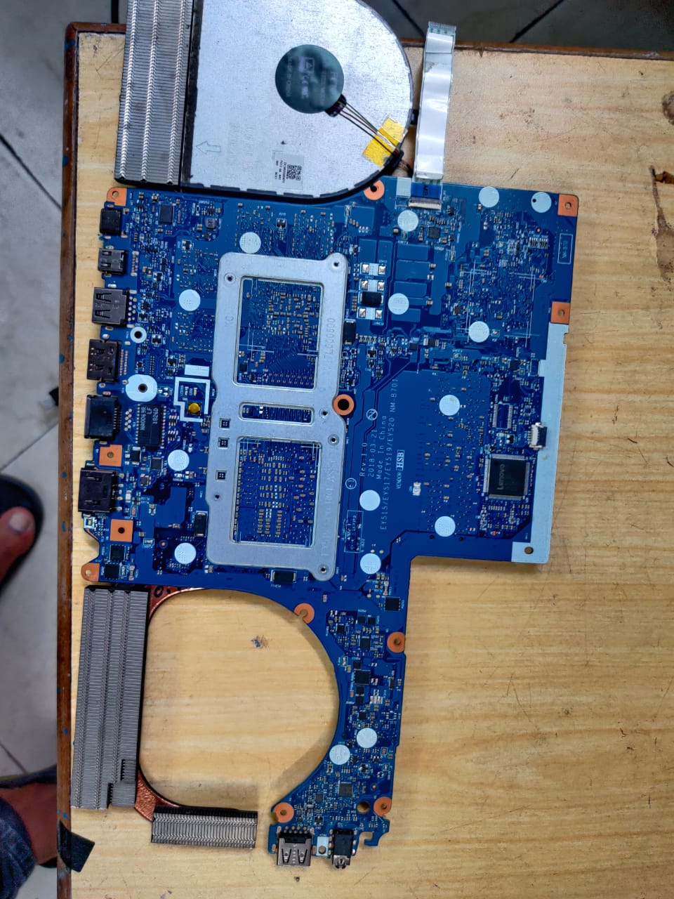

Lenovo Y7000 EY515/EY517/EY519/EY520 NM-B701

Hello, please repair and clean the ME Region, in the ME program Analyze errors for errors.

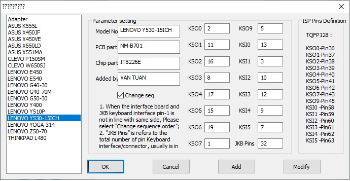

Lenovo Y530-15ICH laptop
NM-B701 Rev: 1.0 board
Note that the error is because you are using Analyze incorrectly, not a BIOS problem and it is not a tool to identify BIOS errors

pins=30 PD0=7 PD1=11 PD2=13 PD3=18 PD4=14 PD5=10 PD6=17 PD7=15 BUSY=4 STB=12 AFD=1 INIT=8 SLIN=9 KSI4=5 KSI5=6
