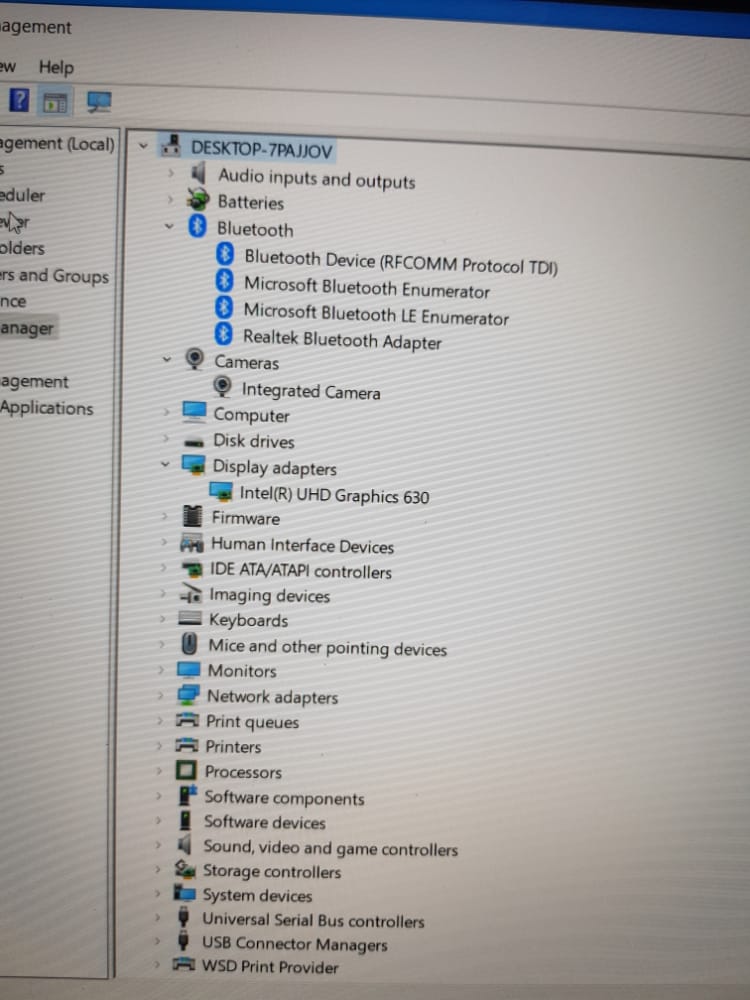

Hello, I am having problem with missing gpu. Intel hd works, type: 81FV. Any solutions? Before bios was corrupted, rewritten, updated from official lenovo site. Winbond 25q128

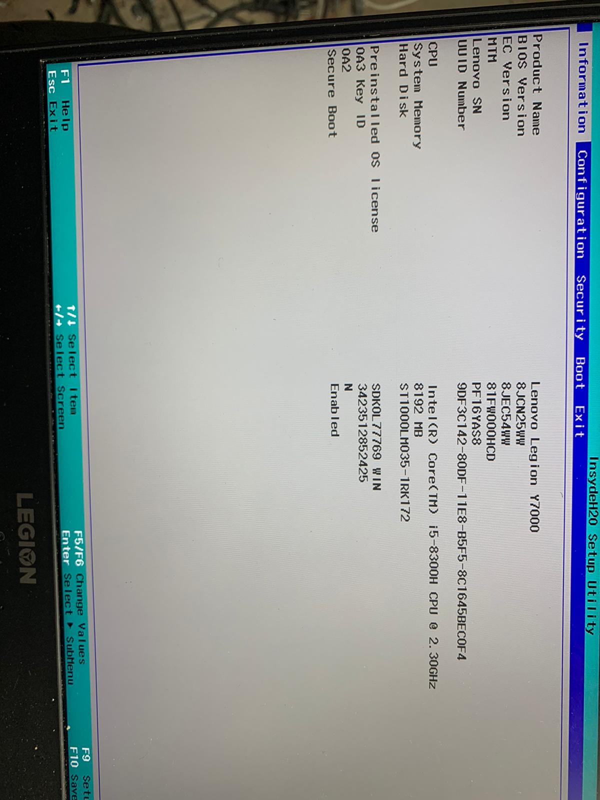

Still no geforce and in bios missing product name, mtm, lenovo sn
you Programming IO?
you Programming IO?
did not program IO, I will try, thanks
