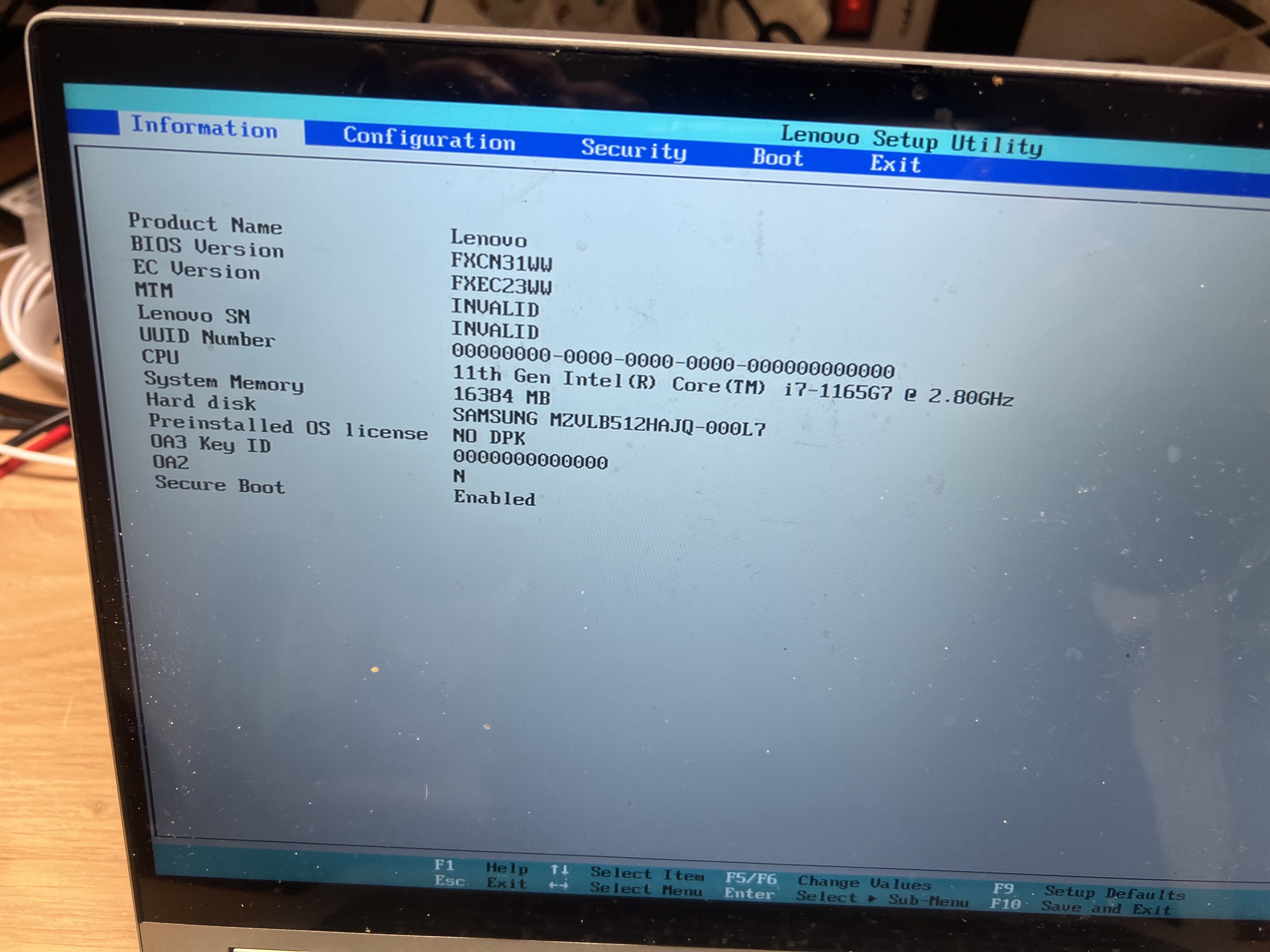

Hi,
dump works fine for only 2 3 minutes and laptop freezes !
maybe missing uuid and another data
could please check thnx

that's not the cause, i think you need to try another BIOS to compare and it could be hardware problem.
Hi,
i tried to reinstall windows from the first build , trackpad not working
TPM in mfg mode - no windows lic,, etc
could please check this dump ( original one no video )
many thanks

there are too many errors I can't even check
