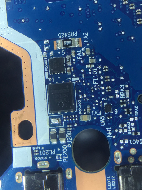

Hello Vinafix community. My Laptop Lenovo IdeaPad 3 15ITL6 does not give light on the screen. I suspect it's the backlight fuse. I haven't managed to get the schematic to know where to look and verify the backlight fuse. It was previously moistened but the mother was already cleaned and perhaps that caused a short and the backlight fuse burned. The laptop turns on and works fine but the screen is dark. I already tried another good screen, because I thought it was the screen but it is still without light. I hope you can help me to correct this problem if you have the schematic or any help from you. Thanks.

FV1 ESE QUE PARECE UN CONDENSADOR PEQUEÑO PINTADO POR LA MITAD ES EL FUSIBLE DE PROTENCION DE ILUMINAR LA PANTALLA

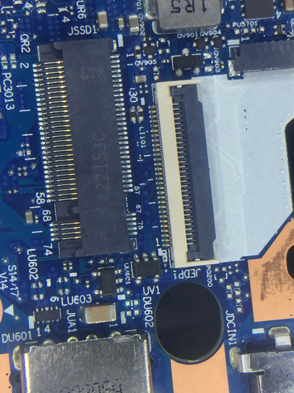

good evening! ..please! ....could you help me with a lenovo ideapad 3 15ITL6 nm-d471 laptop (HS460 HS560 HS760 Rev: 2.0 2020 -12- 10) ... my laptop turns on but does not give video and uses m.2 NVMe drive ..... I installed the two bios that are shown in this forum but the laptop gives video and indicates a recovery failure .... and if you manage to enter the BIOS, it freezes and does nothing else .... please if you can help me ... I attach the two BIOS (8Mb and 16 Mb) of my motherboard so that you can transfer customer data and clearme .... thank you

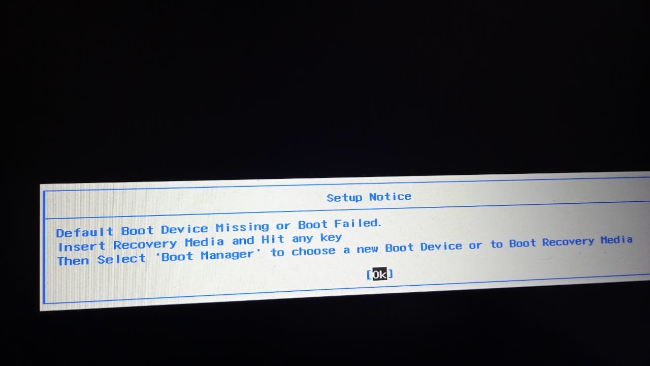

Good evening! Thanks for responding and for the information sent!....Well I have already loaded the two BIOS files (8MB and 16MB) sent by you but now the laptop only gives an error message as if no boot disk was installed....I reset the laptop again in order to enter the BIOS configuration using the F2 key and the laptop seems to get stuck or frozen because it does not show me the BIOS menu and only a dark screen with the backlight on is seen....What could be the fault then??....Could you help me??....Thanks

Need to try another BIOS if there is the same problem, it is not due to the BIOS
Could you give me a different BIOS for this laptop that uses an M.2 (NVMe) drive? Another question... I see that some colleagues here have asked you for the method to deactivate the soldered RAMs... At what point should these RAMs be deactivated? I see that one of the power phase coils towards the processor is heating up more than normal and the voltage drops from 1.8v to 1.67v approximately when it starts up... Thanks

M2 you need buy patch 35$
