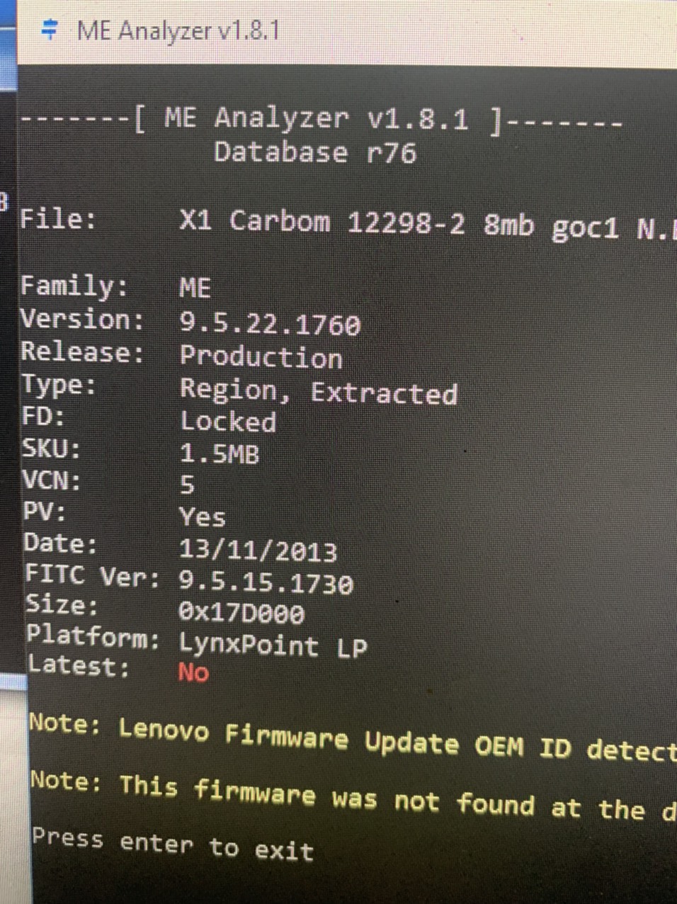

hi, need region, thank you!!!
║ radek_msi.BIN (1/1) ║
║ Family │ ME ║
║ Version │ 7.0.4.1197 ║
║ Release │ Production ║
║ Type │ Region, Extracted ║
║ SKU │ 1.5MB ║
║ Patsburg PCH Support │ No ║
║ Date │ 2011-02-01 ║
║ Size │ 0x17D000 ║
║ Downgrade Blacklist 7.0 │ <= 7.0.3.1194 ║
║ Downgrade Blacklist 7.1 │ <= 7.1.2.1049 ║
║ Chipset Support │ CPT ║
║ Latest │ No ║
