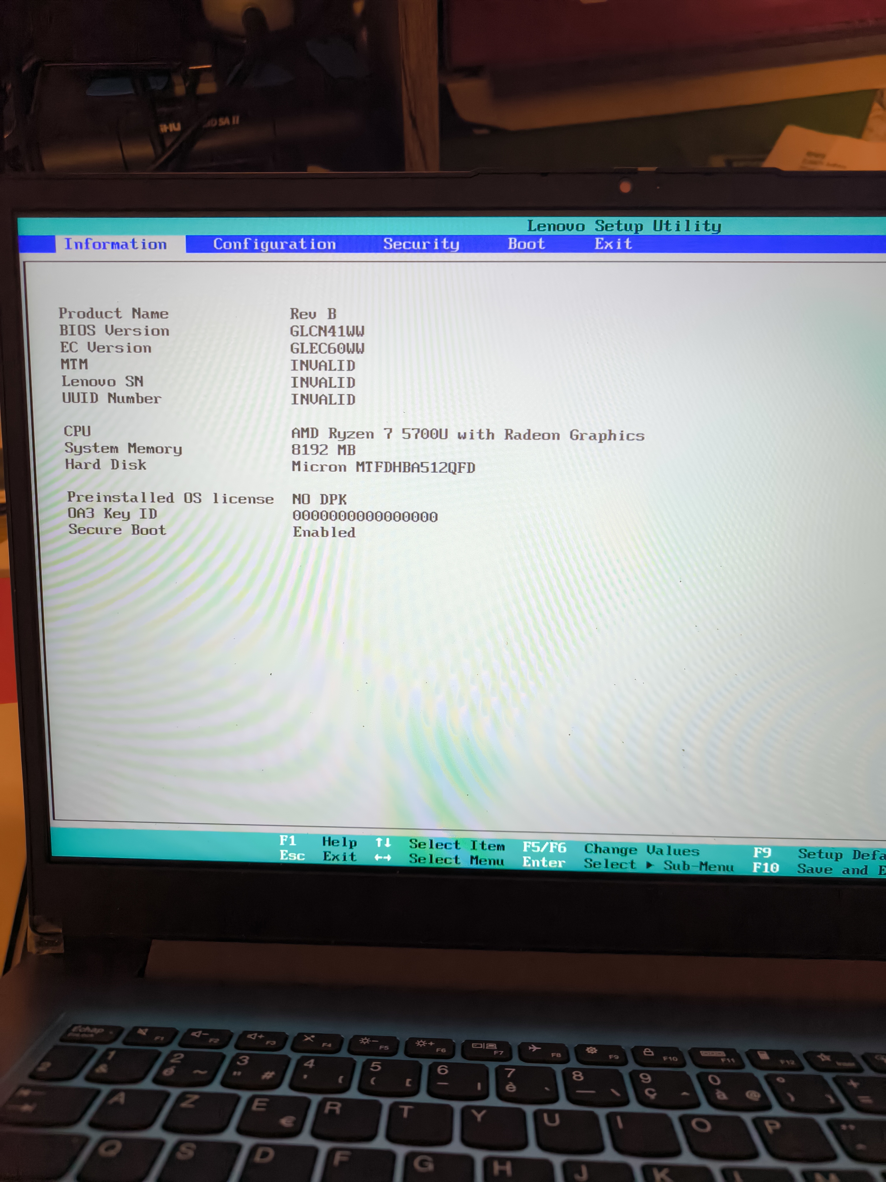

hi, thank you for the bios. Now i got a display but he didin't boot. i have just accss to the bios setup and i can see parameter invalid. Screenshot for see. Can you corriged the bios for that please ?
of course because the BIOS has been programmed
That doesn't affect the problem of the computer not working
its ok i have just reset the bios setup and he work fine. for flash you need a programmer like ezp2023+
