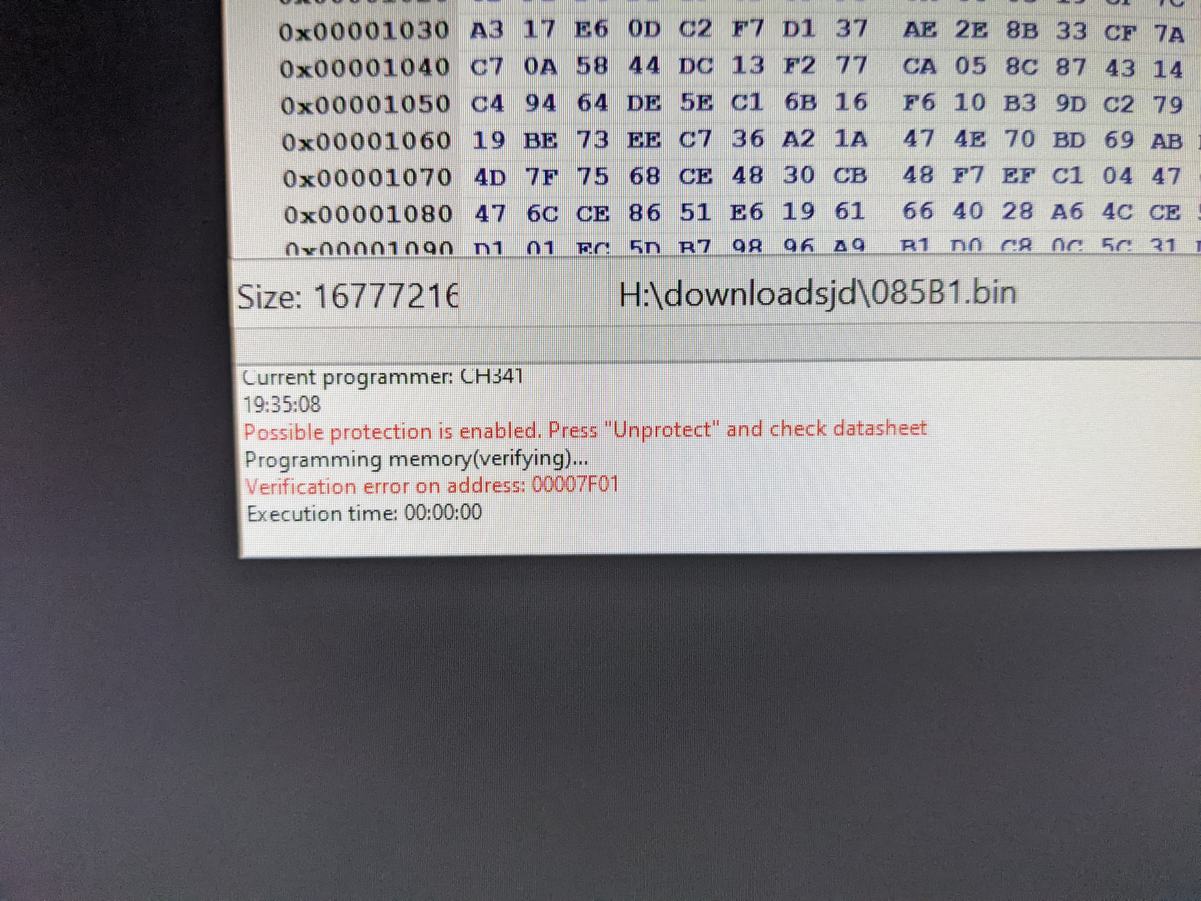

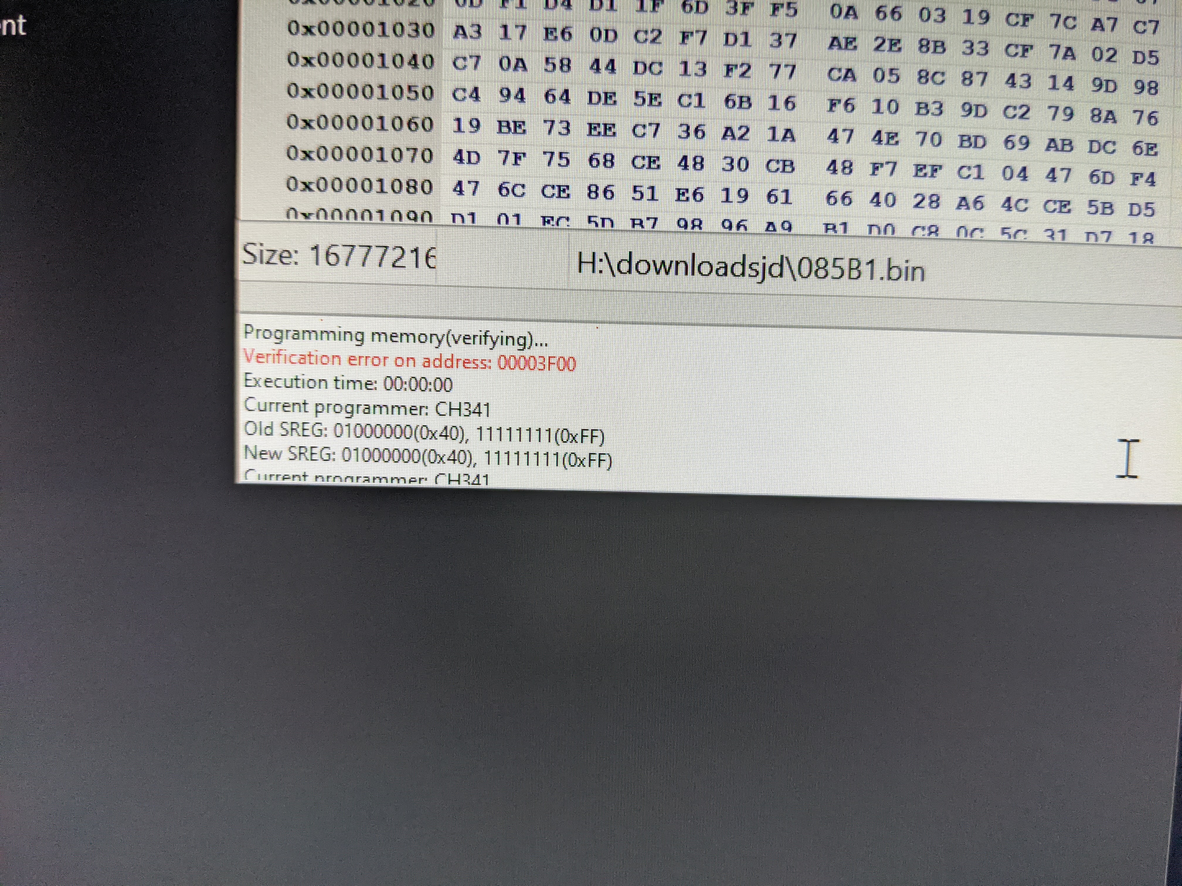

Chip is MX25L12873F and is 1.8V, I am using CH341A usb programmer, do I need some adapter or it should work normally.
View attachment 151178View attachment 151179

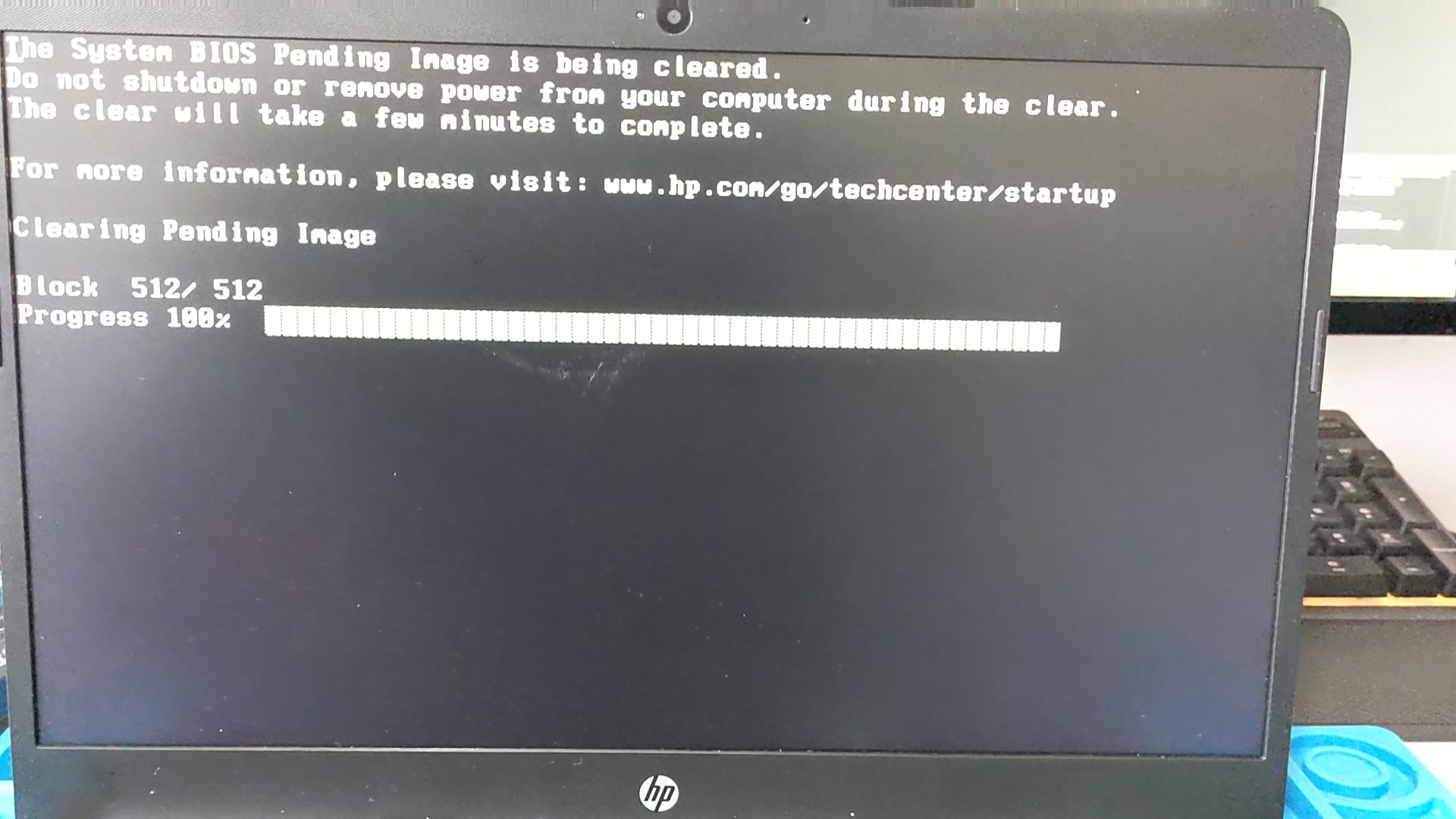

chép 2 file trên cũng hiển thị như vậy 2-3 giây rùi màn đen thui là sao ad @ThienBui giúp vsHi with 1.8V adapter I am able to write new bios. Using 1st bios from 1st post is blank screen using 084A2.bin I got screen for 2 seconds, then is reboot and blank screen again.
Does anyone have EC dump??? Or anyone have idea what can causing this?
