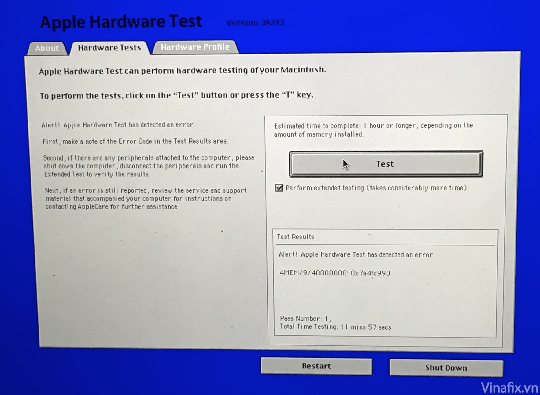

    If the Apple hardware diagnostics test determines there is a problem and reports an error, you should write down the error code and any provided details (or take a picture of it with your iPhone) so that you can learn more about the problem. Noting the error code will also help to relay information to an official Apple Technical Support advisor or an Apple Certified Repair center. For Macs with Apple Diagnostics, there is a list of error codes found in Apple Diagnostics here on support.apple.com, whereas Apple Hardware Test error codes are a bit more self explanatory for technically inclined, and they can be searched for on the web to determine a potential match.
    Alert! Apple Hardware Test has detected an error
    4MEM/9/40000000 0x7a4fc990
    Screen Shot 2016-07-07 at 5.28.59 PM.
    If you do have a hardware problem and the Mac is in warranty, the hardware issue will be taken care of by AppleCare if you contact the official Apple Support channels. Some errors can be resolved by the user by doing something like testing memory and replacing problematic RAM or hard drive (though if it’s in warranty you shouldn’t bother yourself), whereas other errors you will almost certainly need a certified repair center to deal with, like a GPU or logic board problem. Again, if the Mac is in warranty, let Apple or a certified repair center fix it.
