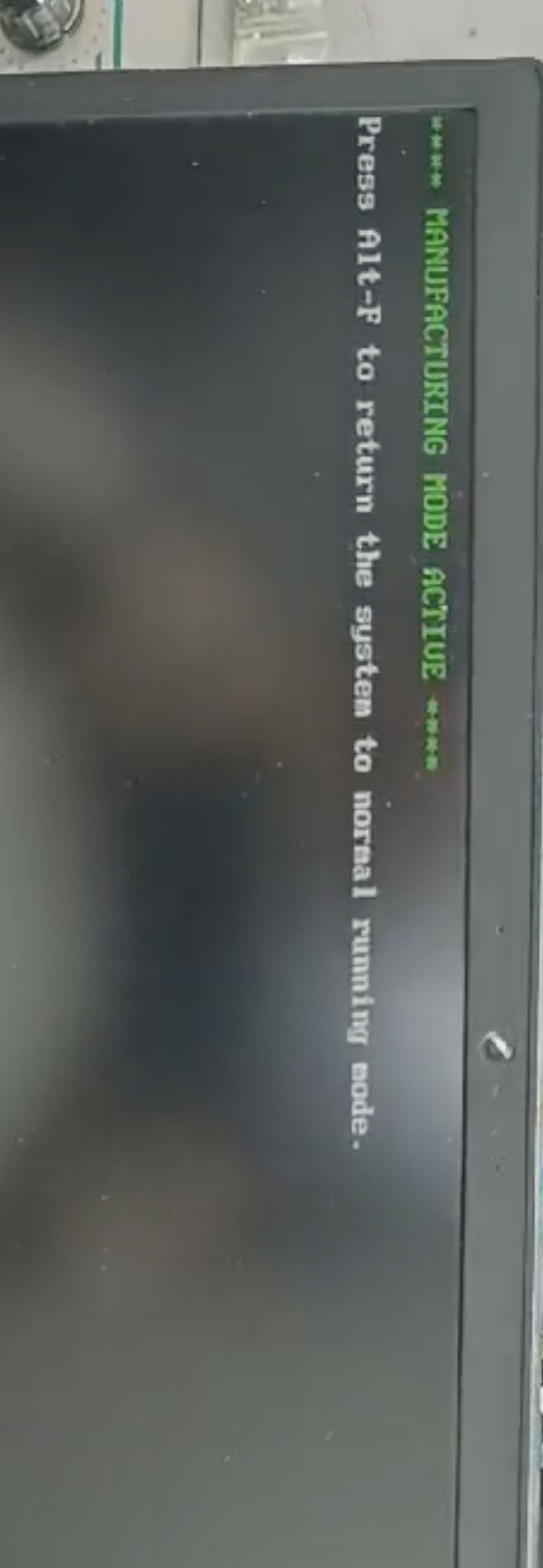

As i mentioned above laptop was dead because of shorted mosfet on battery input voltage after replacing mosfet device turned one but it shows 4 Amber one white , and it was not going in bios stuck on dell logo and same goes to F12 ONE time boot menu too ,

AS i told above initial problem was not with bios actual problem was shorted mosfet and because of that Battery charging ic I2C Data pin was shorted so it gives 4 amber and one white that issue I resolved it I am here if you can kindly tag here a working bios with my motherboard refrence thanks

With this attached bios finally its shows Dell logo then it goes manufacturing mode unable to skip with ALT+F , After once it shows manufacturing mode then it turn off to turn on again i have to take off CMOS Battery and again same message , can you please fix this bios with my service tag so I can boot it normally thanks i will appreciate that .

need buy patch 35$

Funcionando al 100
