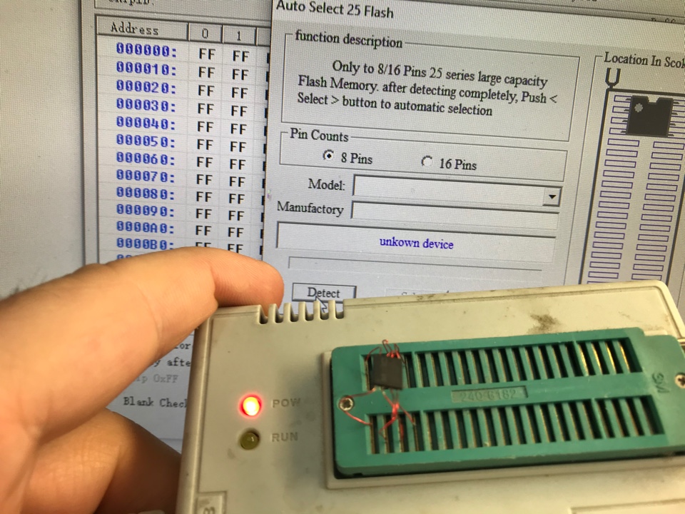

yes but it cannot be recognized by the programmer. Look in the picture. Also is not in the supported list of TL866a.
no the chip. is ok. I put it again in the motherboard and the mac turned on and show me the lock button. This is the reason that I need to flash it. Is that possible with this programmer? Which programmer did you use for this chip?
Yes, I think only is problem connect.

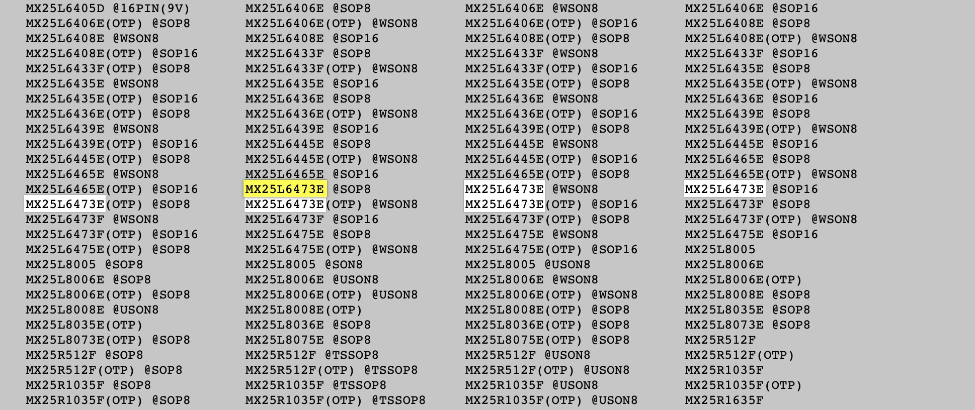

This is for MX25L647E but I dont have this. I have the chip MX25L647EZNI-10G which is different. which not included in this list. But I will try a new connection.
I tried a lot ways to read it. It is not possible. After a big research I found the programmer that It can read this chip. The programmer is RT809F . Maybe I must buy it. Right? thats your programmer that you had read this bios chip?
only same MX25L647E :(
