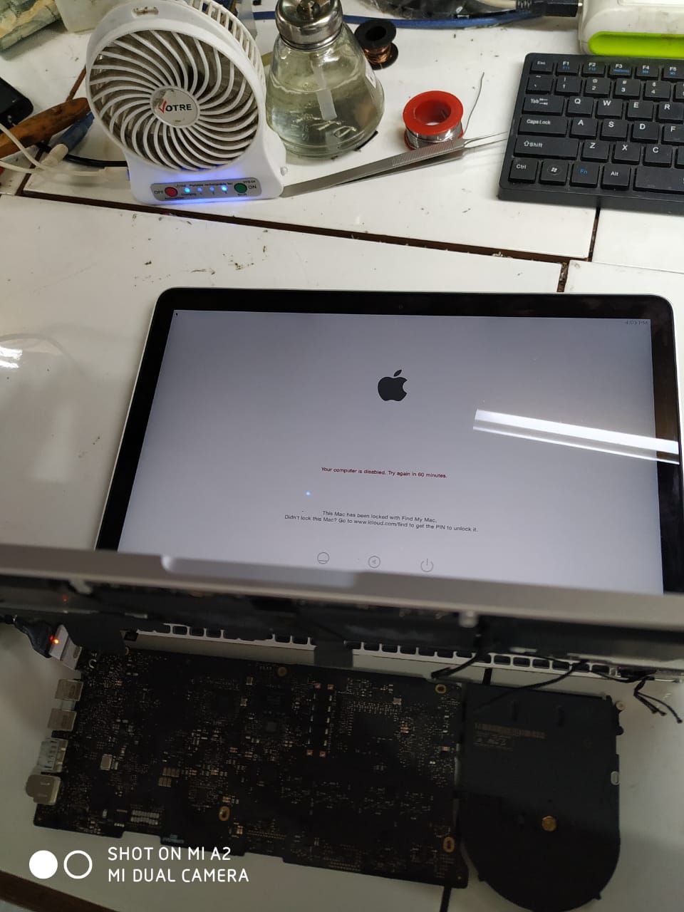

originally it was coming on loading operating system and then restarted like a big loop 10-20 seconds time. so i reflash the bios after that and the ssd stop getting detected
if it happens to the original bios then 100% of the problem is not from the BIOS.
i have received another macbook same type which doesnt display on main screen but does on the HDMI so i tried your clear me and i was right the SSd wasnt getting detected . After soldering the original back all came back to normal .
i am uploading the bios fully working for A1502 EMC 2835
SERIAL : C02QLAQKFVH3
means after clear me the display is ok but don't receive the SSD?
