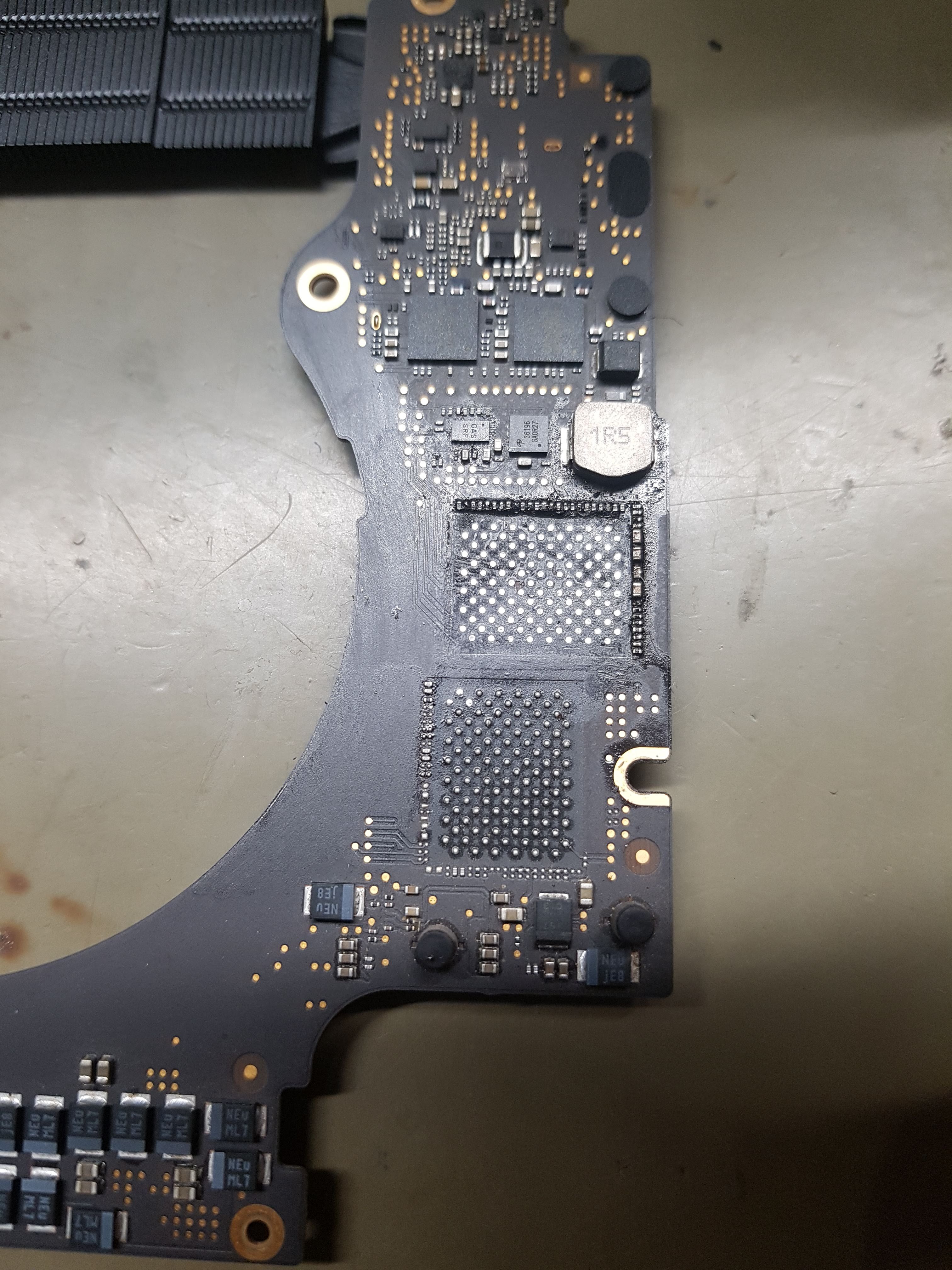

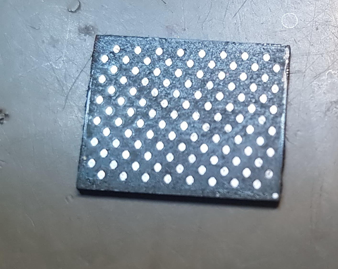

the macbook was not turning on.

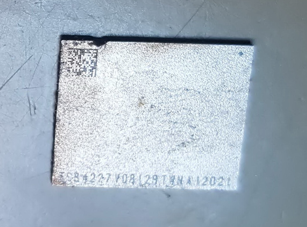

had a burnt mark on u8600 near it's corner
it wouldn't go from 5v to 20v
I applied 8v to ppbus_g3h, after that the Mac went from 5v to 20v

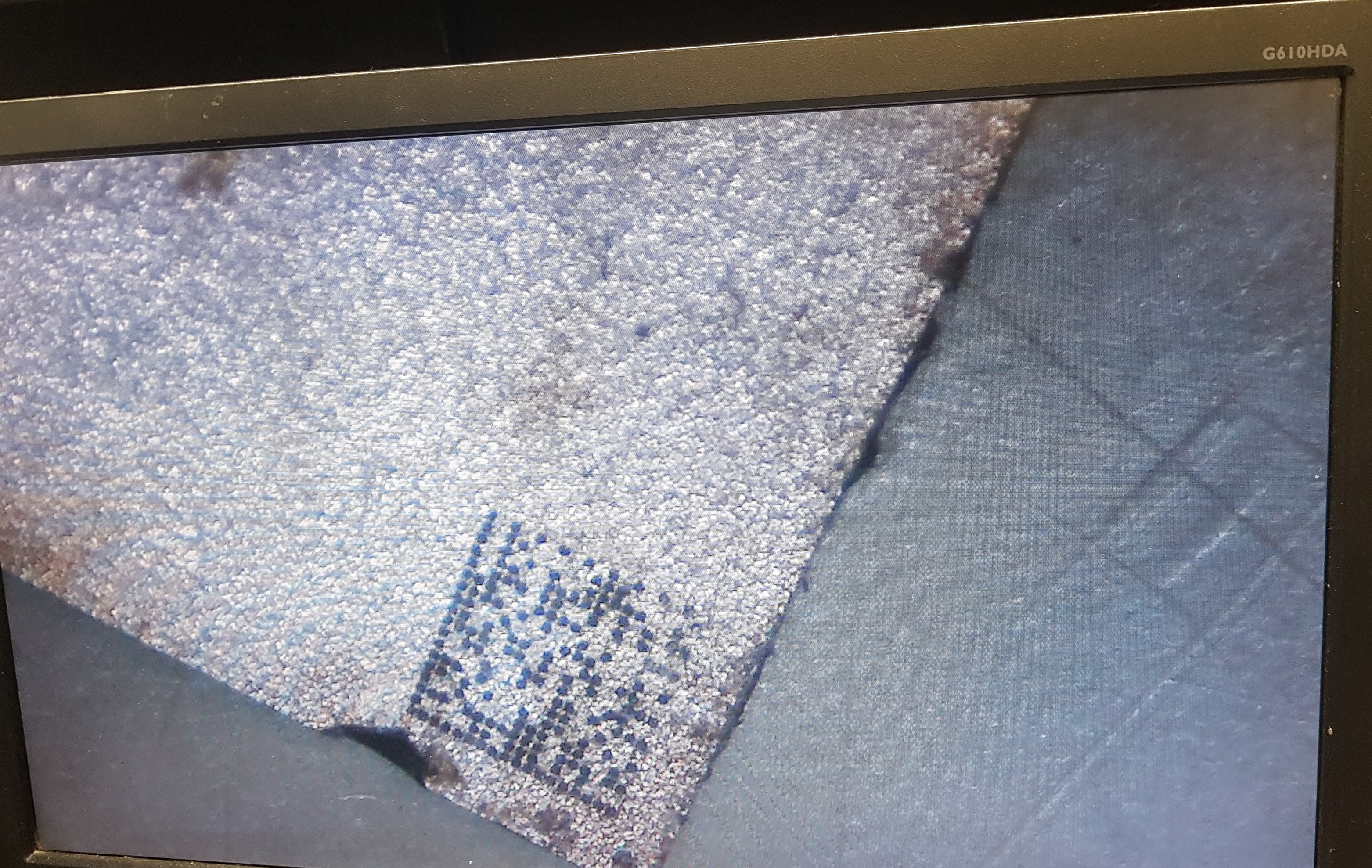

but u8600 was getting very hot, I took it out and tested it out this NAND has internal short to GND on PP1V8_SSD1. so bye bye DATA recovery.
did anyone here has fixed SSD problems on T2 MacBooks?
