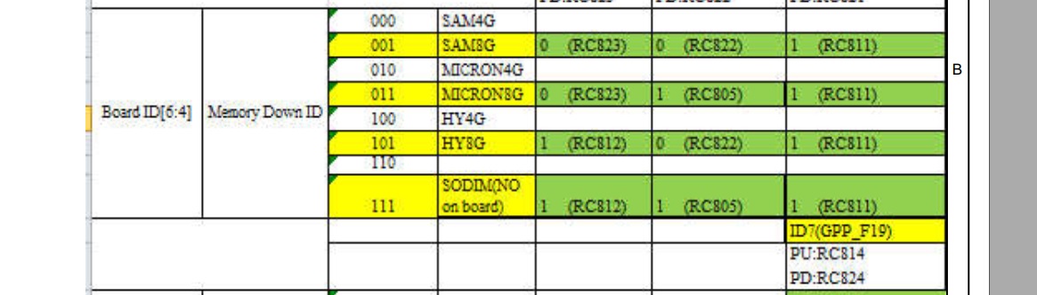

Can anyone understand from this table how to disable onboard RAM?
I put RC812 RC805 RC811 but onboard ram still recognized
