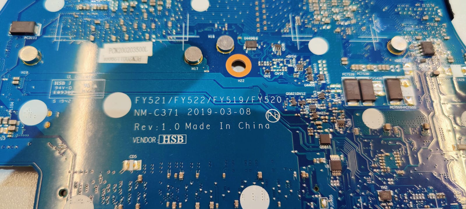

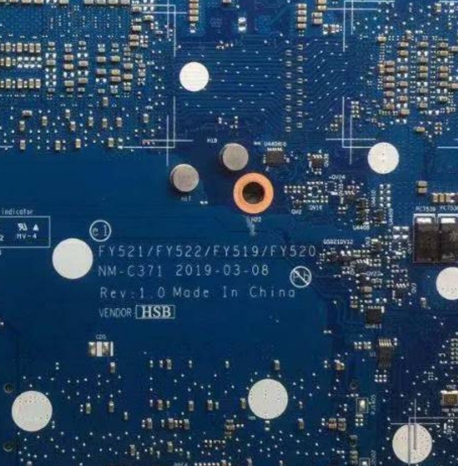

i need help please.
The laptop is showing a message that the charger type and wattage cannot be determined at boot (correct charger is plugged in).
Also after the display comes on, the keyboard is not working (mousepad is working). In BIOS the keyboard is working.
Is this a EC or BIOS problem?
Any help is appreciated, BIOS File is attached. Also motherboard model.
THANKS!

you need to try another PCH bios to compare first I think the BIOS can't have multiple errors at the same time
