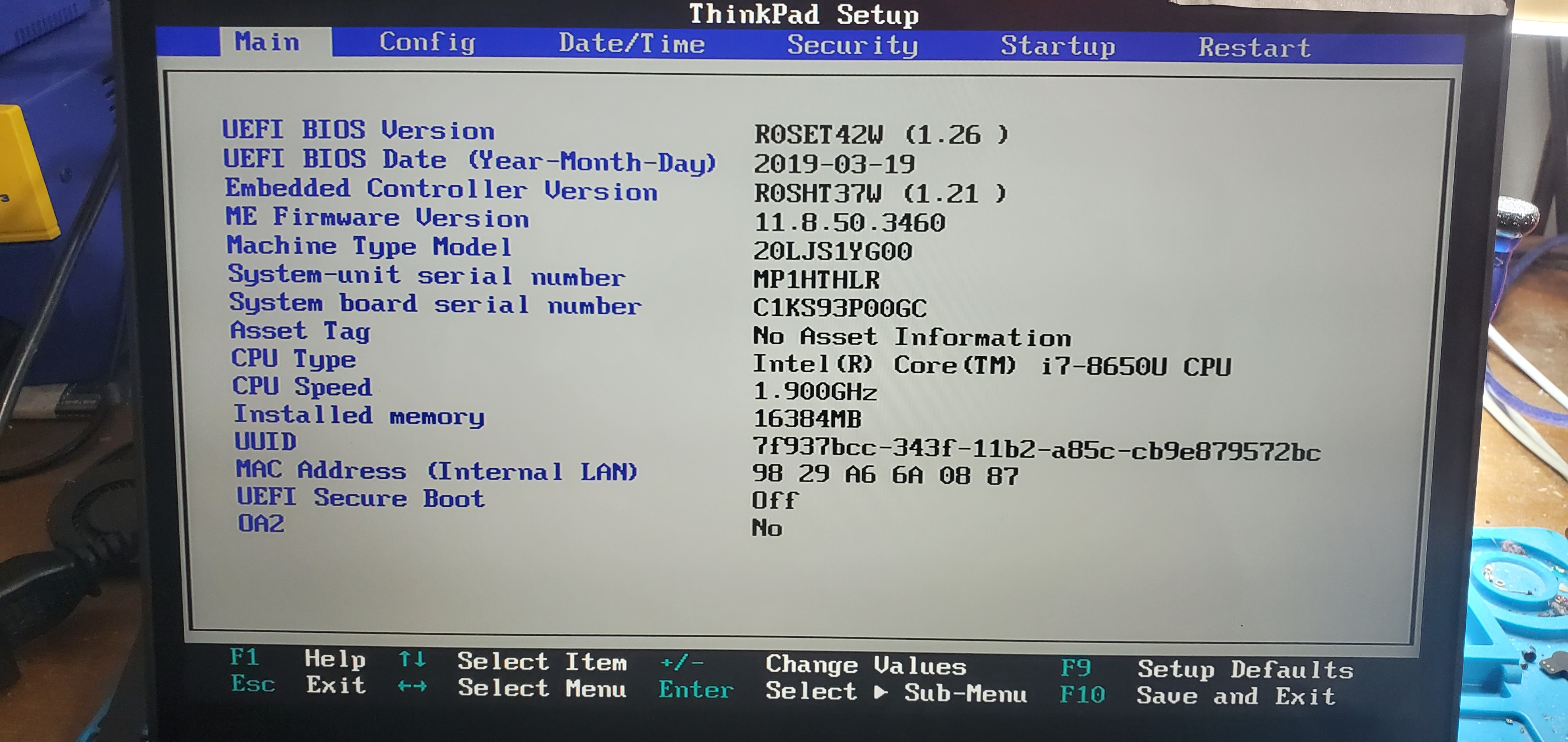

Unreasonable error after BIOS update? you need try BIOS other and compare
I tried with 2 other BIOS, but it has issue, with other BIOS It can not ready SSD drive! And with the original one, it reads SSD, but just one time, after restart it get stuck on booting page.
I think this is not a BIOS problem that can only be fixed if it happens after clearing me
There was a problem with this motherboard, then I tried to update the BIOS, but it did not help. So I found the problem on the motherboard and fixed it. Now system is turn on, but not booting correctly. So I think it does not work well after updating the BIOS and I'm not sure if I tried to clear me before I found the problem or not. That's why I asked if this could be a bios issue.
clear me Available here
Because of uncertainty, I even asked you to try a different BIOS
Hi anh Thiện,
em có chép thử hết những bios của anh ở trên.file bios mà anh clear me thì lên hình,nhưng không nhận SSD.
chỉ có bios này là chạy và nhận SSD và LAN ok.nhưng lên rất lâu,mong anh clear và build để nhận SSD và LAN giúp em nhé.
rất mong anh giúp đỡ.cảm ơn rất nhiều.

essayez-le
Bonjour ce ficher il a bien marché mais il ne voit pas le ssd pour que je puisse faire l'installation de windows j'ai essayé tout les configurer de bios mais toujours il ne voit pas le ssd .
ya une solution merci
I also don't know where you need to check to identify the problem
