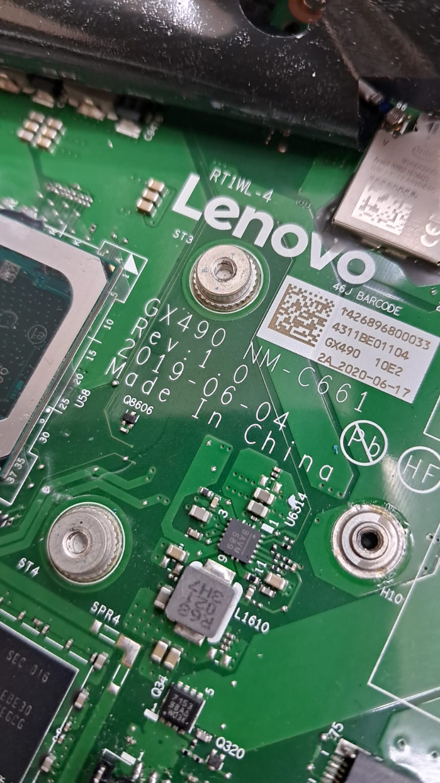

With this BIOS, no power.
The original power, but no image.

MB: GX490 NM-C661 REV 1.0
10th GEN Intel cpu
The problem its the EC firmware MEC1663. you have a file to replace?
After replacement, check to see if the power supply is adequate?

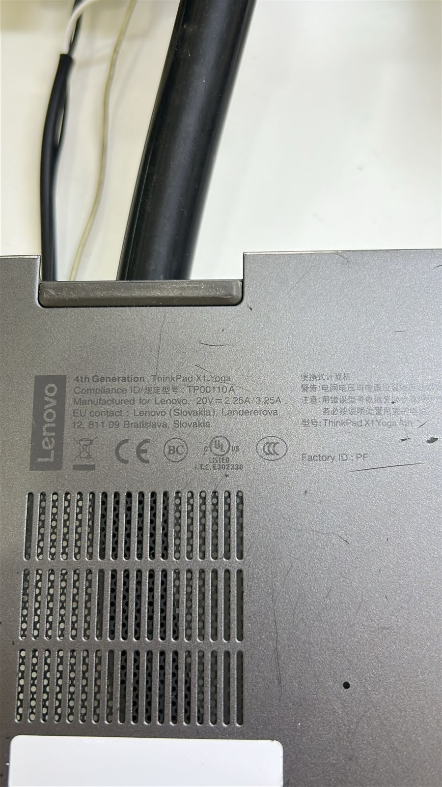

The laptop shutdown during a firmware update.
I tried flashing two different firmware (BIOS and 1mb chip), but the problem persists.
It powers on, but there is no display.
I suspect it might be the MEC firmware, but I can't find the correct version for this model.

need bios for x1 yoga nm-c661. 20sa. region is n2qht20w. not n2qet..w. do u have?
