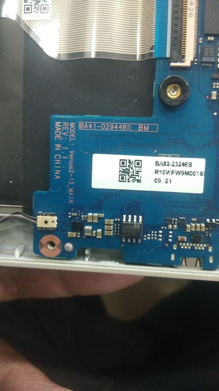

motherboard is BA41-02882C not BA41-02288CVENUS-13_15-INT Samsung BA41-02288C GD25B127D@SOIC8 P11RFX
not same Motherboard code BA41-02882C. ?hi sir can you fix this bios stuck in logo
hi sir can you help fix this bios no display same board code BA41-02882C
So the laptop has no bios errorstill has no display sir but when i put this one https://vinafix.com/threads/venus-13_15-int-samsung-ba41-02882c.47365/post-363429 it has display but the ssd cannot be detected is there a solution
originally it is a bios error with no display i tried all the bios above and this one works but ssd is not detected even if i put a new ssd can you help build this one for me https://vinafix.com/threads/venus-13_15-int-samsung-ba41-02882c.47365/post-363429 to recognize the ssdSo the laptop has no bios error
I didn't know this before and above you just asked me to build BIOS from you providedoriginally it is a bios error with no display i tried all the bios above and this one works but ssd is not detected even if i put a new ssd can you help build this one for me https://vinafix.com/threads/venus-13_15-int-samsung-ba41-02882c.47365/post-363429 to recognize the ssd
ok sir can you help me rebuild this bios, ssd not detected in bios setup even if i put a new one... thankyou sirI didn't know this before and above you just asked me to build BIOS from you provided
nvme will not work with clearme BIOS and non-original BIOSok sir can you help me rebuild this bios, ssd not detected in bios setup even if i put a new one... thankyou sir
try thisnvme will not work with clearme BIOS and non-original BIOS
Thanks boss it works your the best.. Cheerstry this
