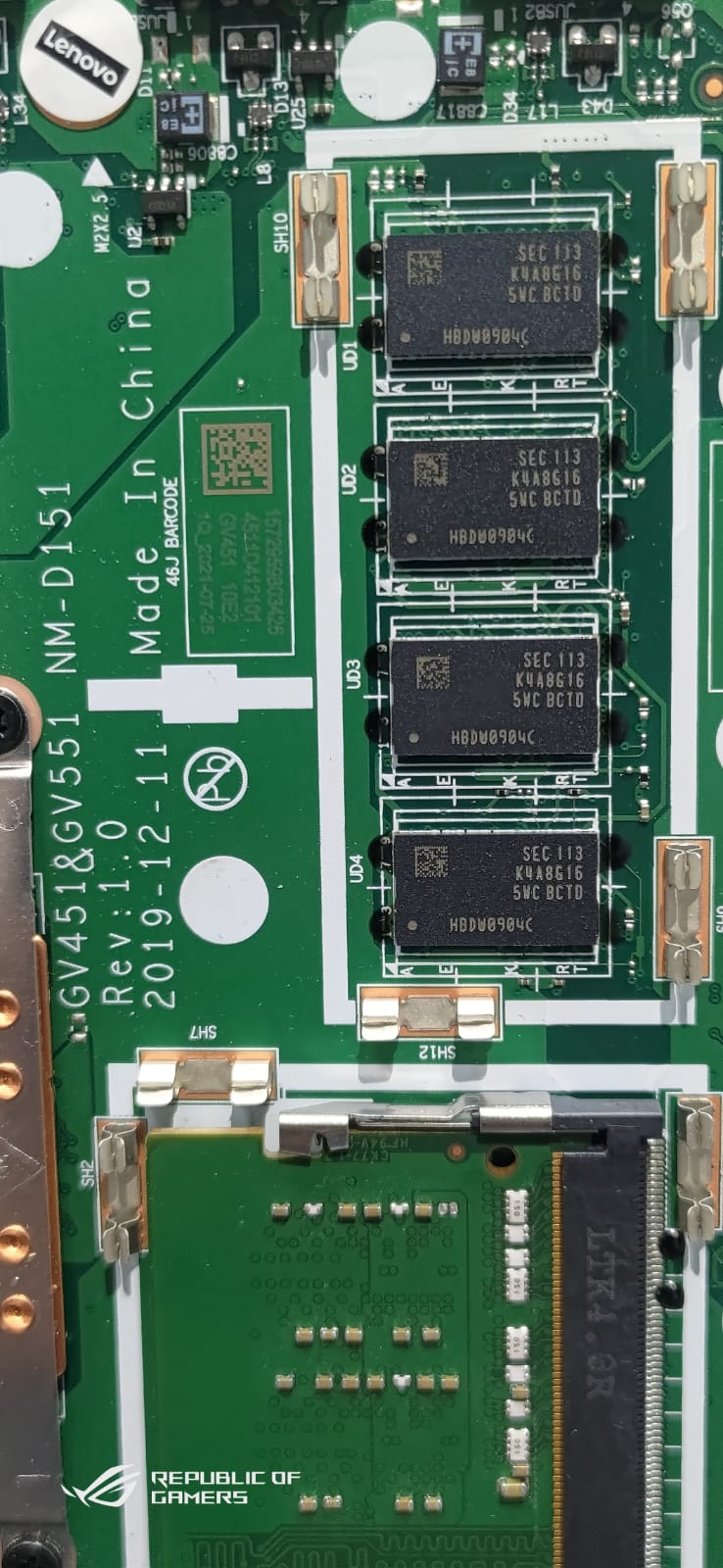

Lenovo Ideapad 3-14ADA05 NM-D151 GV451 GV551 Rev1.0 2019-12-11 photo

after bios update it doenot turns anymore. black screen
I think you need to try a different BIOS for the laptop to work before thinking about the S/n . information
If you keep the original information but the laptop doesn't work, it's meaningless
Thanks it worked, there was no DMI information in the new bios, I took care of it.
