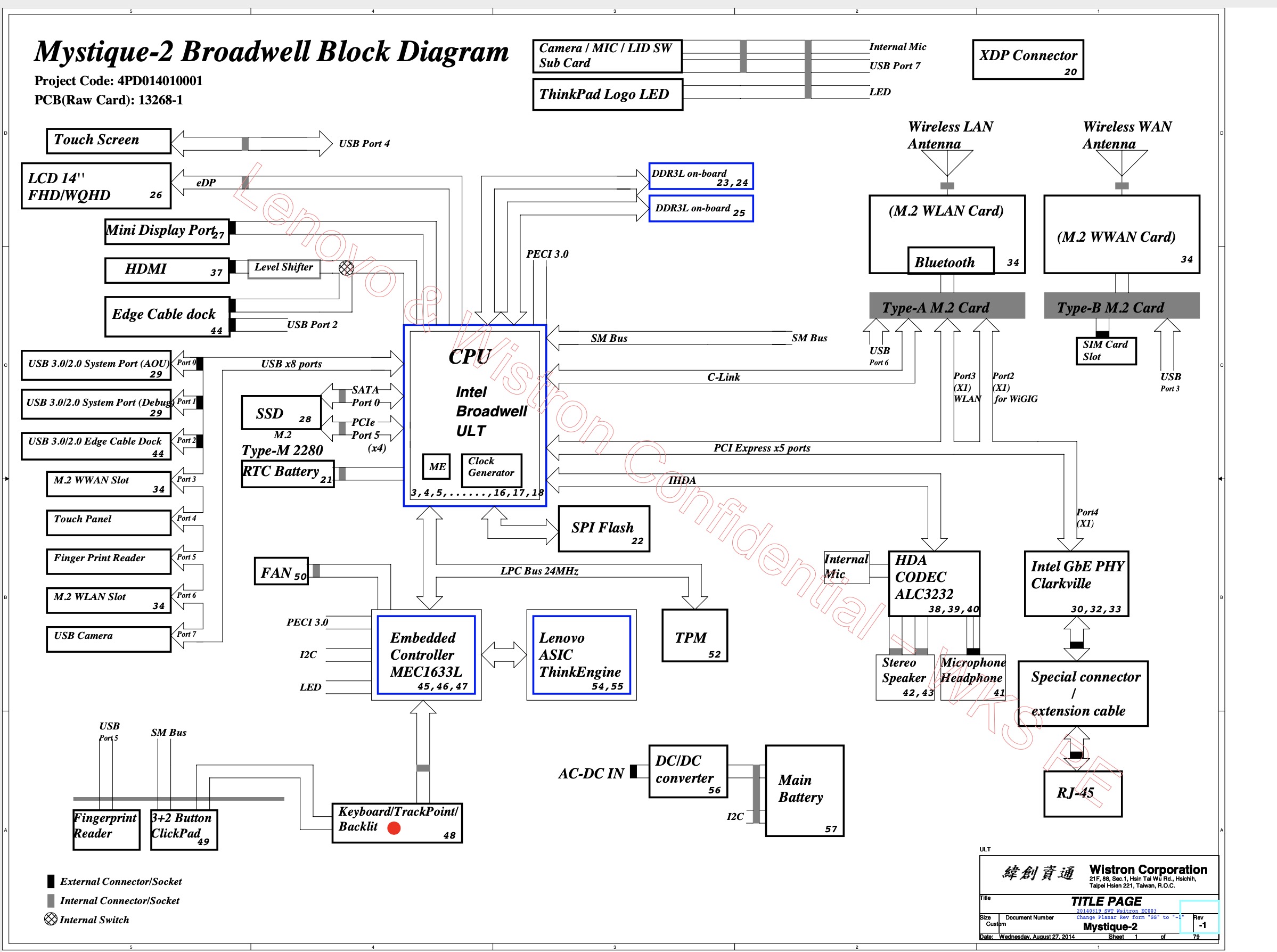

Good afternoon , I need bios for LENOVO x1 Carbon REF : LMQ -2 13268-1 448.01430.0011
Processor : Intel Core i7-5600U
Schematics 13268-1
Thank you

Thinkpad x1 - 13268-1
BIOS 25q128
X1 Carbon 3rd Gen (Type 20BS, 20BT) Laptop (ThinkPad) EC 13268-1
boardview ThinkPad X1 Carbon 3rd Gen Wistron LMQ-2 13268-1
25q128.bin.zip
13268-1.pdf

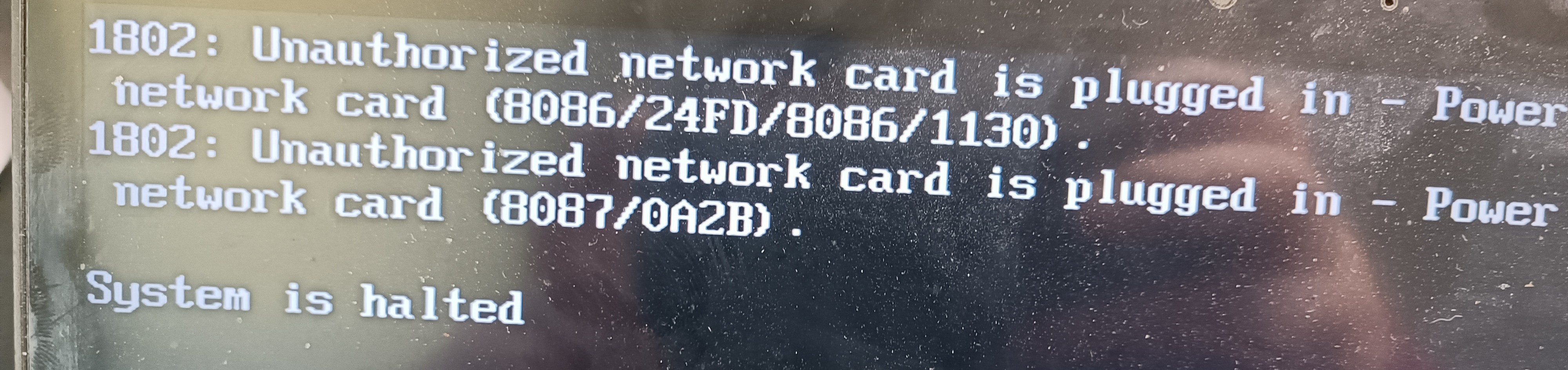

Hi. After replacing mb for another one i get error 1802. I was trying many wifi modules with no success. Can you modify my bios that can work with the original wifi card? Please?
old.BIN
