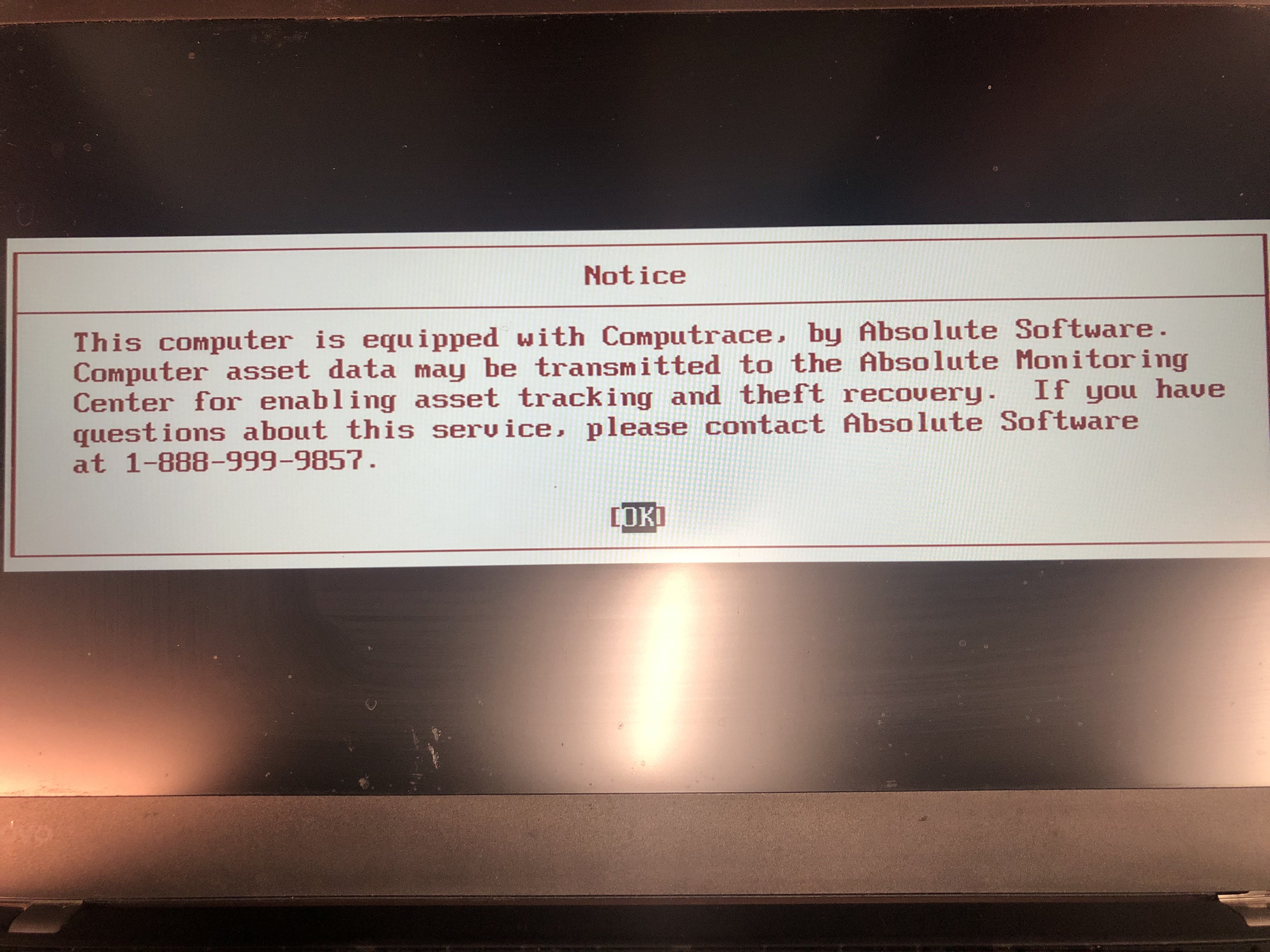

it works but now there is new FAKE error
replaced 3 new M2 always the same error....
only late display of post bios...that's all
everything worked well - i tested with different M2
it's all ok now - 1 m2 was realy damaged and the other was formated bad
BIOS is working properly
thanks a lot
