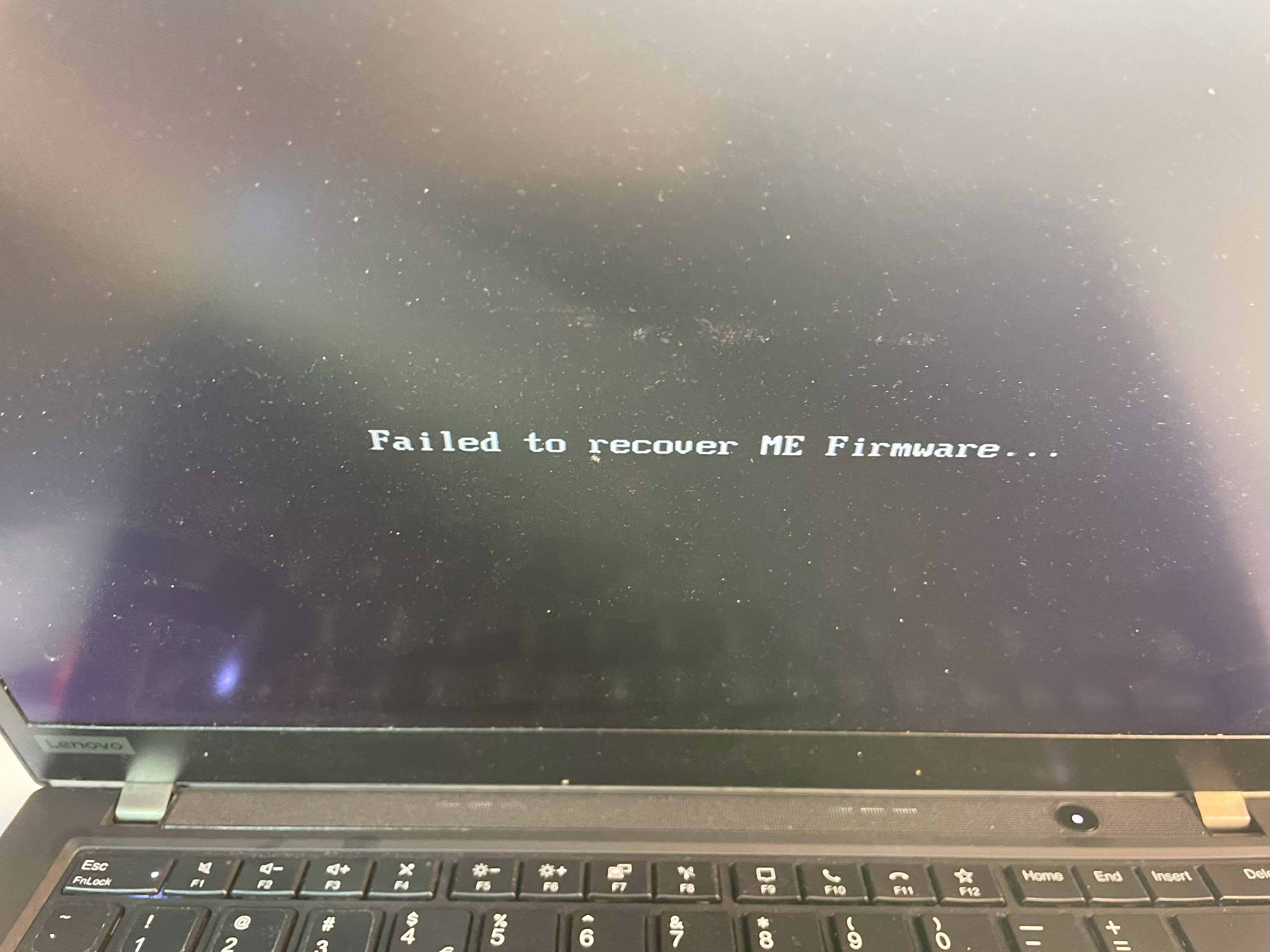

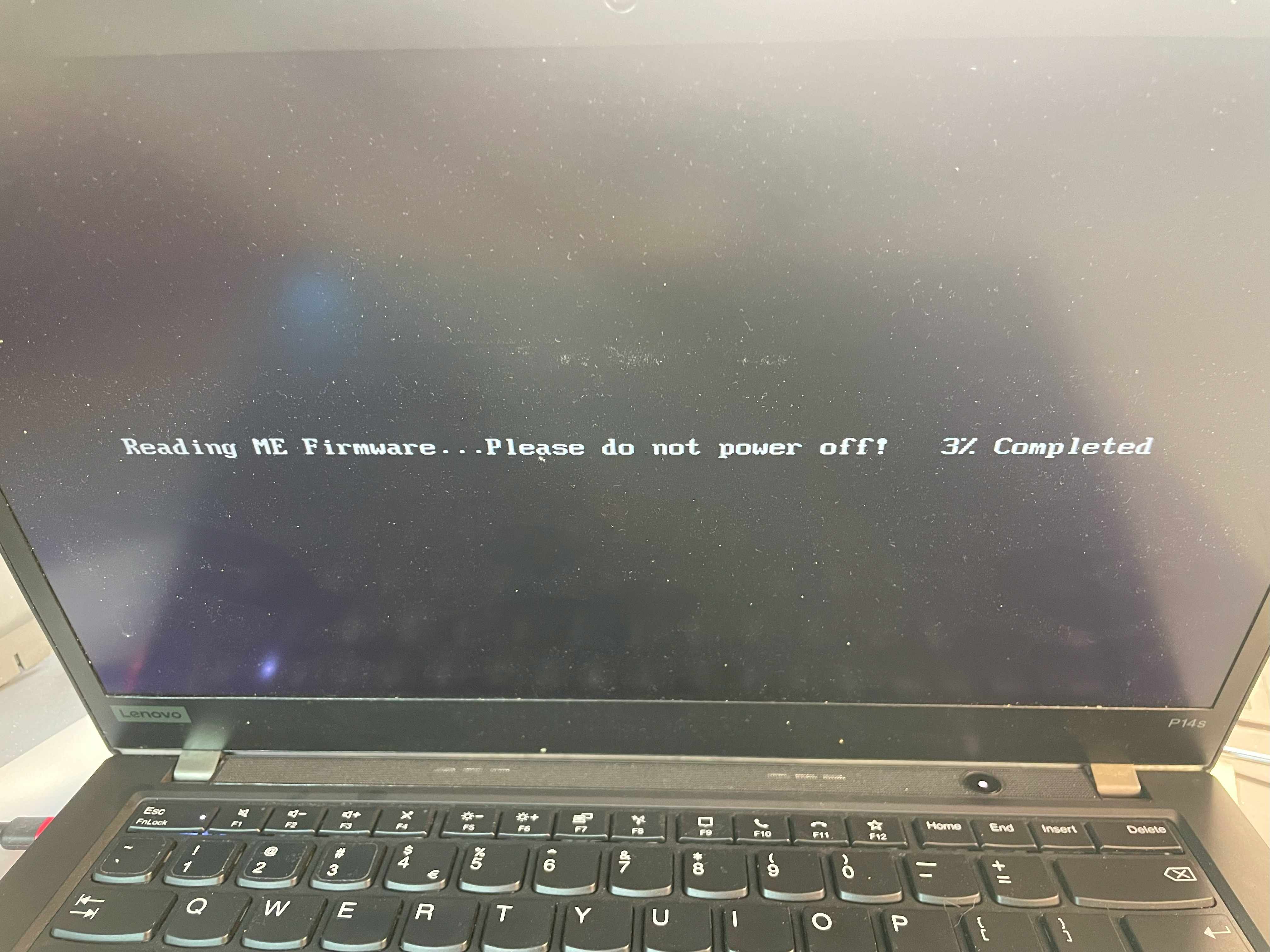

Thanks, but it doesn't work, the laptop doesn't start. In the meanalyzer it shows a lot of errors. Besides, my meregion is 15.0.50.2633
