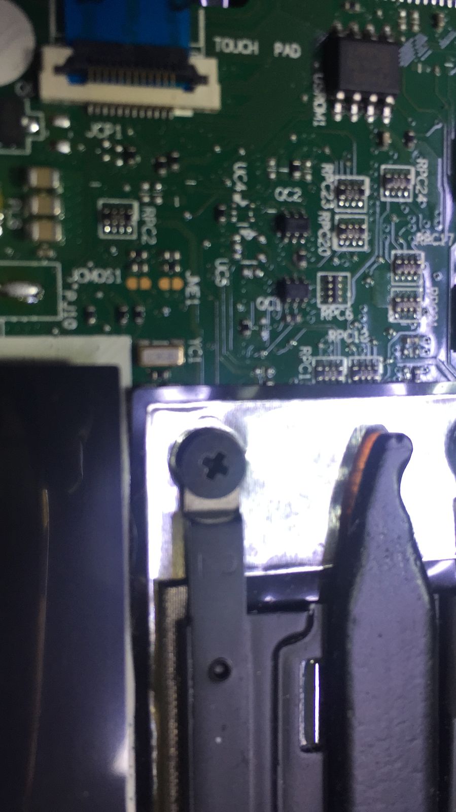

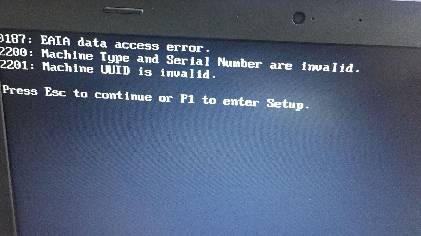

the laptop came to me without spi
So you need to program the BIOS provided by us and check the ITE to see if it is programmed? you didn't program it but maybe someone programmed it before you, understand??
or can try tool this
Thanks !!!
ThinkPad-Hardware-Maintenance-Diskette-Version its works!
