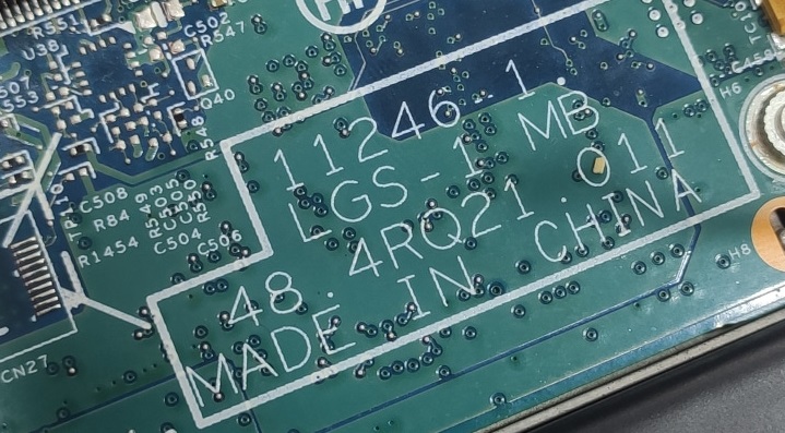

Lenovo Think X1 carbon 11246-1
MEC1619L on a lenovo X1 Carbon
motherboard is 11246-1
pinout (Eight-pin plug that comes out)
2-TMS mec16
3-TDO mec16
5-TCLK mec16
6-GND
7-TDI mec16
On the MB needed:
add R1440 - 100-300om (R1445 you can not touch)
add R1454 - 2-15om (necessarily)
file here
https://vinafix.com/attachments/len...46-2-lgs-1-mb-48-4rq01-02-mec1619l-bin.73611/
Hi!
It's supposed that I have a 11246-1 model but can't find R1440, I found a CN27 wich aparently has the jtag pins but it is 20 pins. Could you tell me where exactly is R1440 located ?
