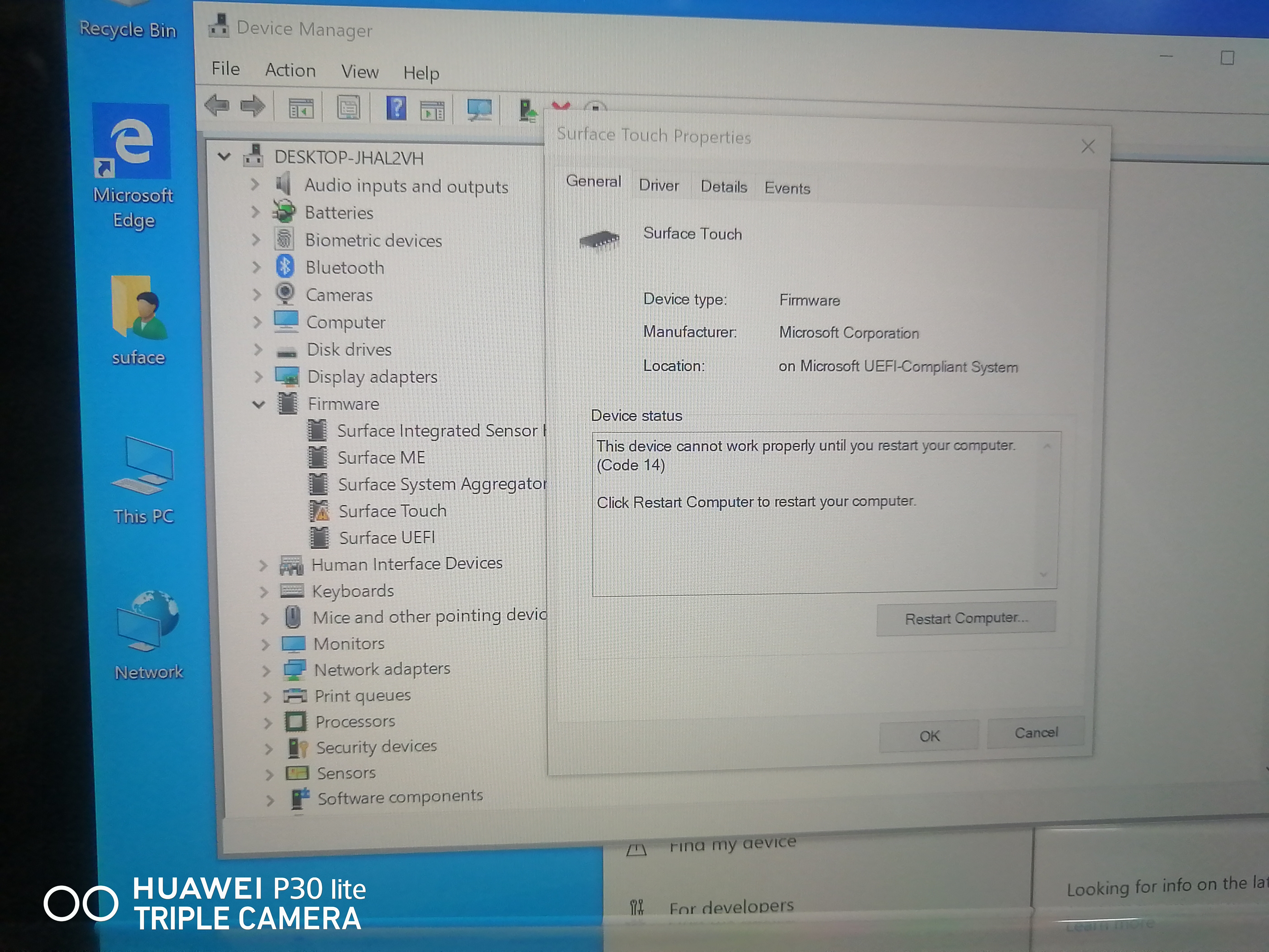

No touch with new bios.
Old no boot.
Help please

I told about it here . i mean "no touchscreen work with new bios"No touch with new bios.

make one video show touchscreen not work I checkI told about it here . i mean "no touchscreen work with new bios"

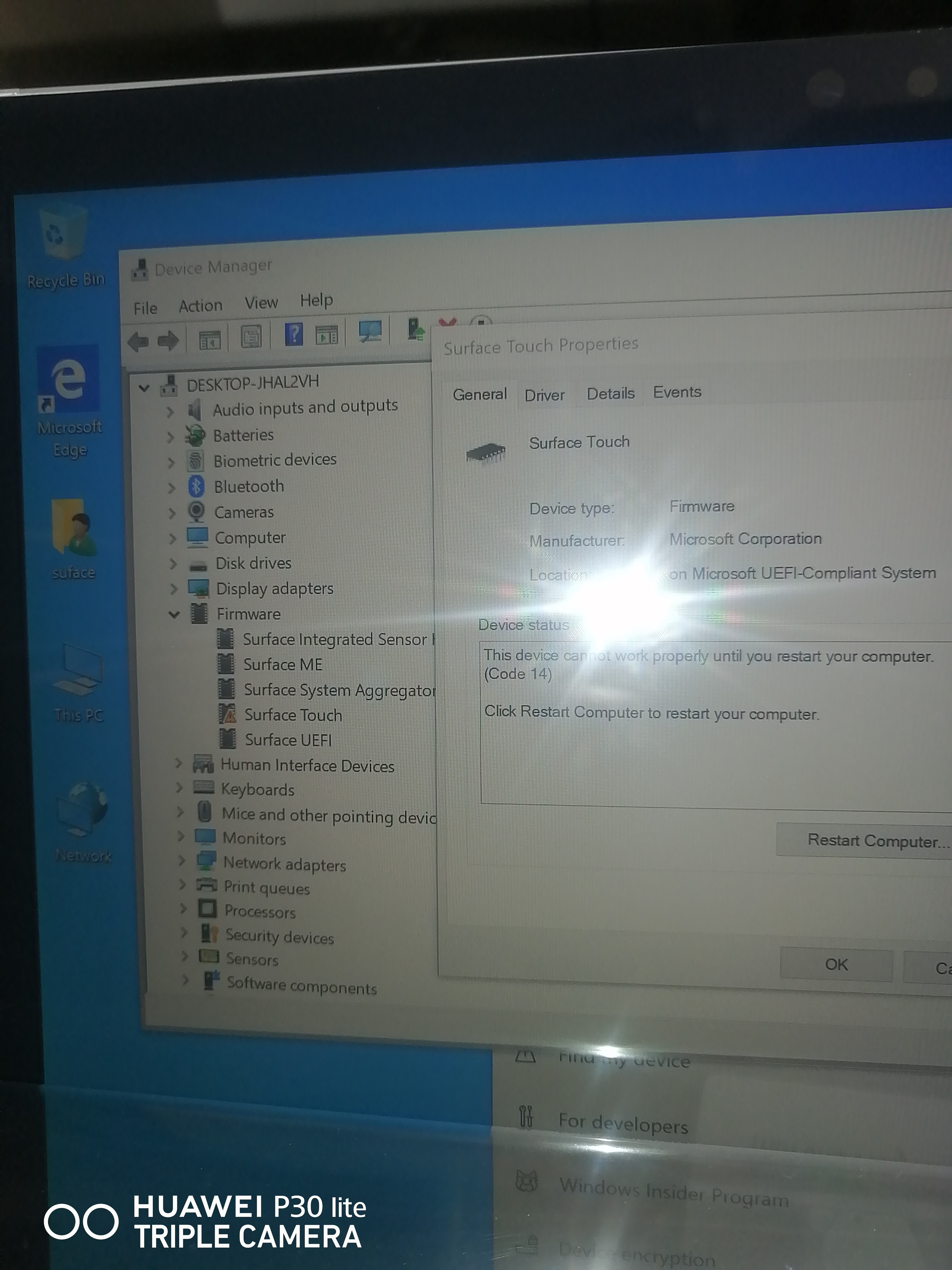

send I file BIOS in videoTouchscreen wil not work with new dump in this topic , but os is booting ok . Surface touchscreen have code 10 , i already try to reinstall driver but device is gone
its file in a topic
surface pro 5 ok.bin.zip
Surface has always been like that, if you lose the original BIOS, it will be very difficult to fix the toucPlease check if u can fix it
cannot be repaired without the original BIOS that came with this machine.pro 5 touchscreen not work
