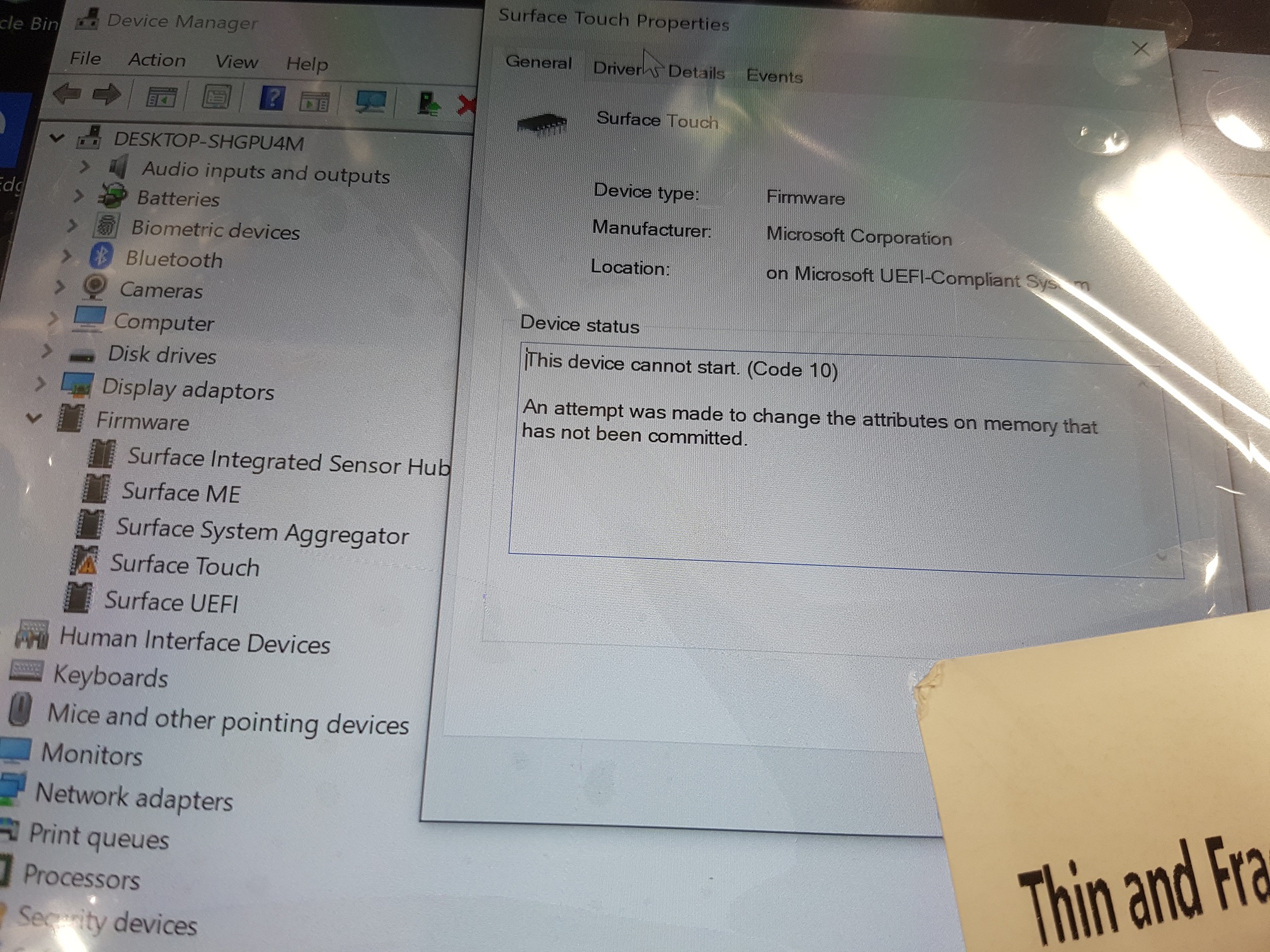

Surface Pro 5 shows 2 seconds logo, then OFF
Flashed Donor board BIOS --> boots okay but no touch
Plz EDIT serial number
Original BIOS (broken, no boot) and DONOR BIOS (OK, but no touch) attached.
Can you help me build a working BIOS please?

Hello!
I have a Surface pro 5, M1007506-015 board, was not booting correctly.
Microsoft logo came up, 4 secords and off. no boot
