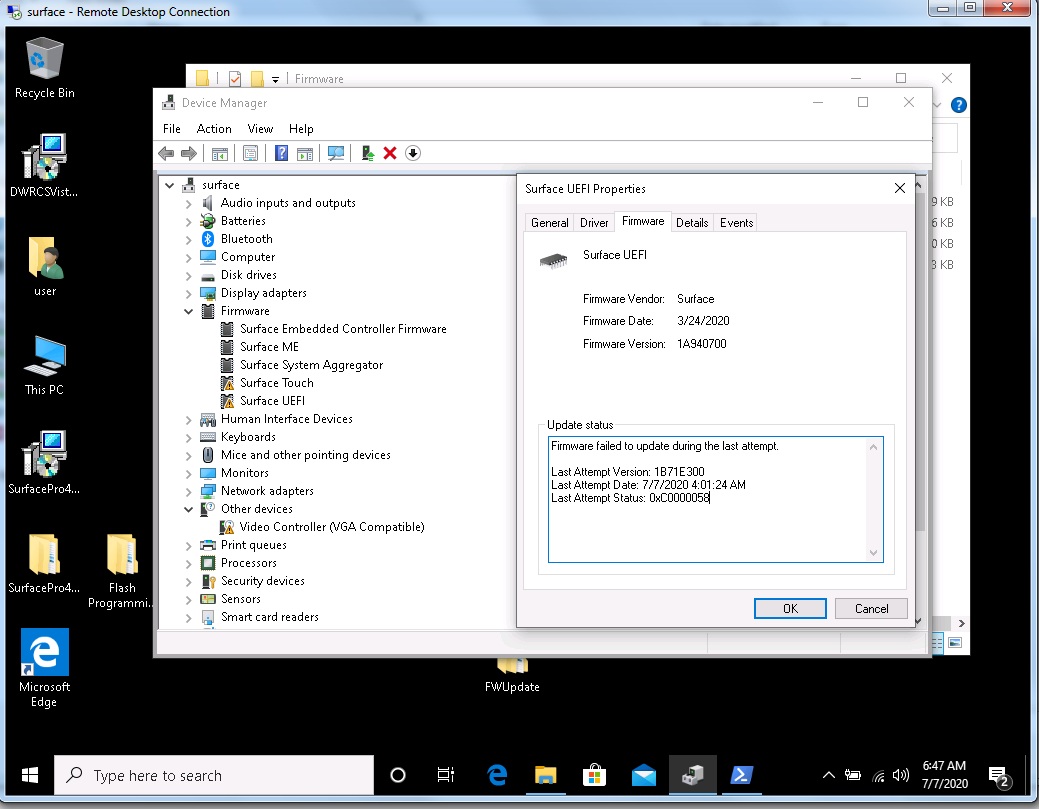

when flashed this bios laptop stuck on surface logo. I have found the the latest UEFI ROM from microsoft, but it's not the full size of the bios region (Bios Region after opening in FIT tool is 10MB). does someone know how to build it to the bios dump? also attached the ME region came from microsoft. and also the EC rom (which came separated, maybe the EC is programmable? or has additional chip for EC rom?)

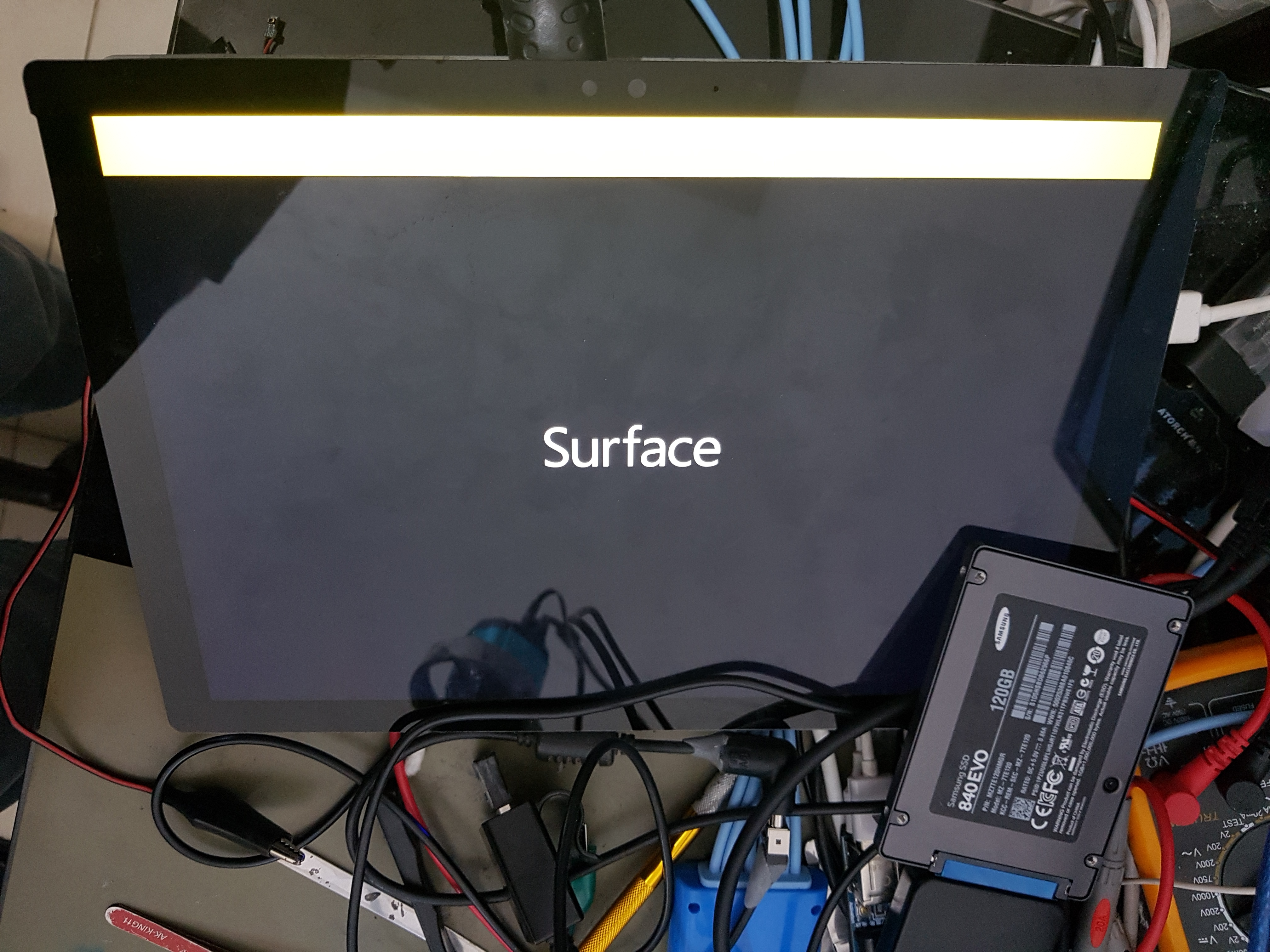

original bios error, laptop turn on, but no display. after flashing Surface pro 4 i7 8g x911788-009 W25Q128(8K BIT OTP) BF.BIN ----- show display but stuck on surface logo. of course i cleaned ME region. still stuck on logo, can not boot to usb nothing boots

now i received another surface same model, same problem, client said sudden black screen. i tried many bioses, the only one the shows the screen is this bios i now uploaded, but with this file. surface shows display, but stuck on logo. can't boot to USB, can't go to Bios settings. i tried clean ME with FIT. nothing helps. very strange

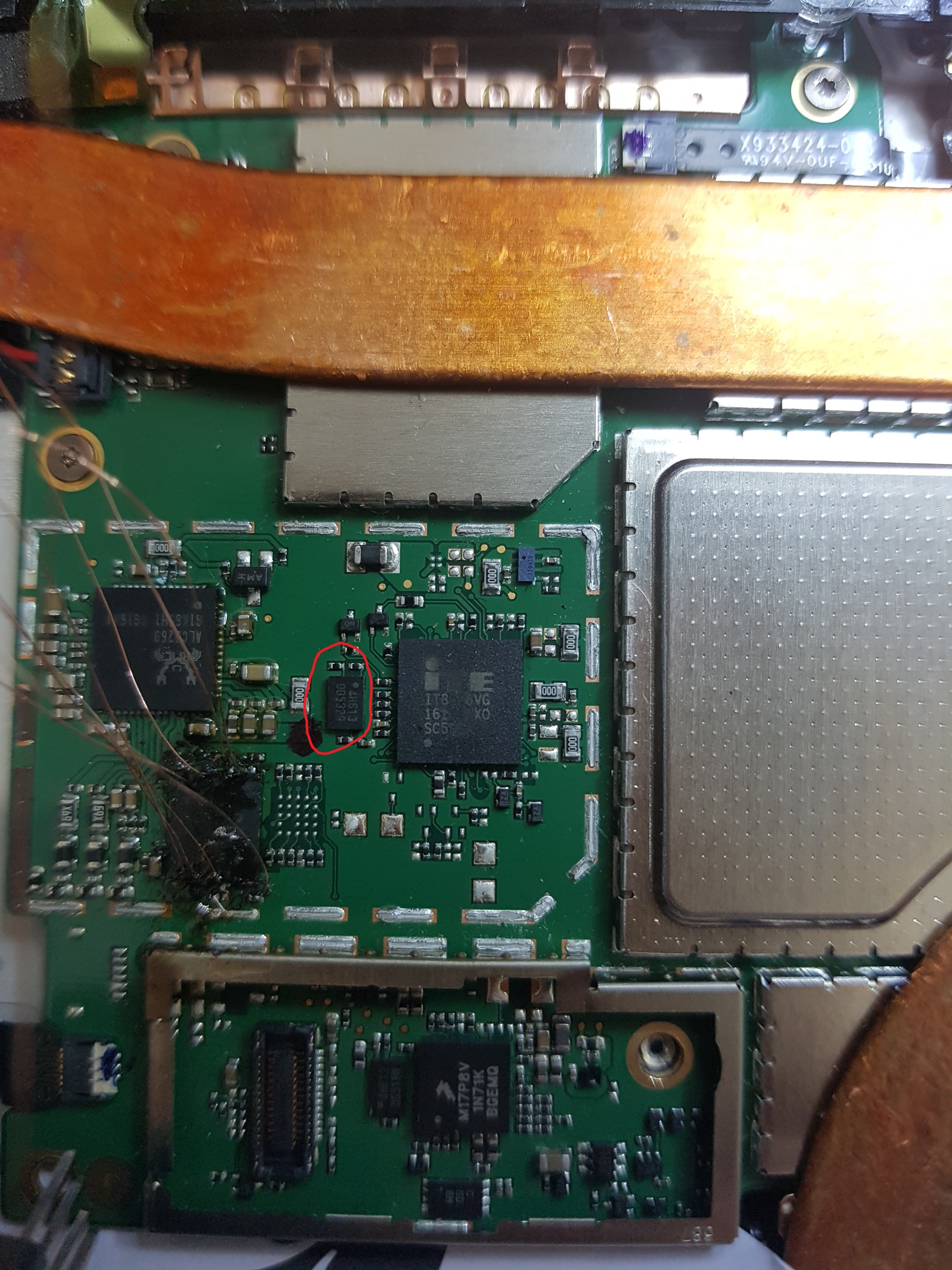

i think the problem is not only bios. i think there are more eeprom, that need to reprogram. i took this dump from this chip near the EC chip. i think it's the EC rom. can you confirm? do you have a dump?

i put another Windows PE USB drive, which has windows logon sound. and i hear the logon sound which means, the machine is booting and working in the background. it makes me highly suspect it is the EC rom which is bad too.

it's a W25D40V chip

the problem was after w big windows update, which updated the Bios rom, the EC rom, the Touch rom, the SAM (Surface System Aggregator) rom and the ME region.
all of them got corrupted during the update, i don't know why. maybe micro$oft, tries to kill these surfaces.
i have reflashed the bios with a good bios dump from this forum, and clear ME myself.
now the surface turn on stuck on logo.
but, windows is working in the background, i connected with RDP.
the only FW i can't fix is EC rom and TOUCH rom.
I need a good dump for them.
please help me find a good EC dump, because i have 2 surfaces with the same problem
