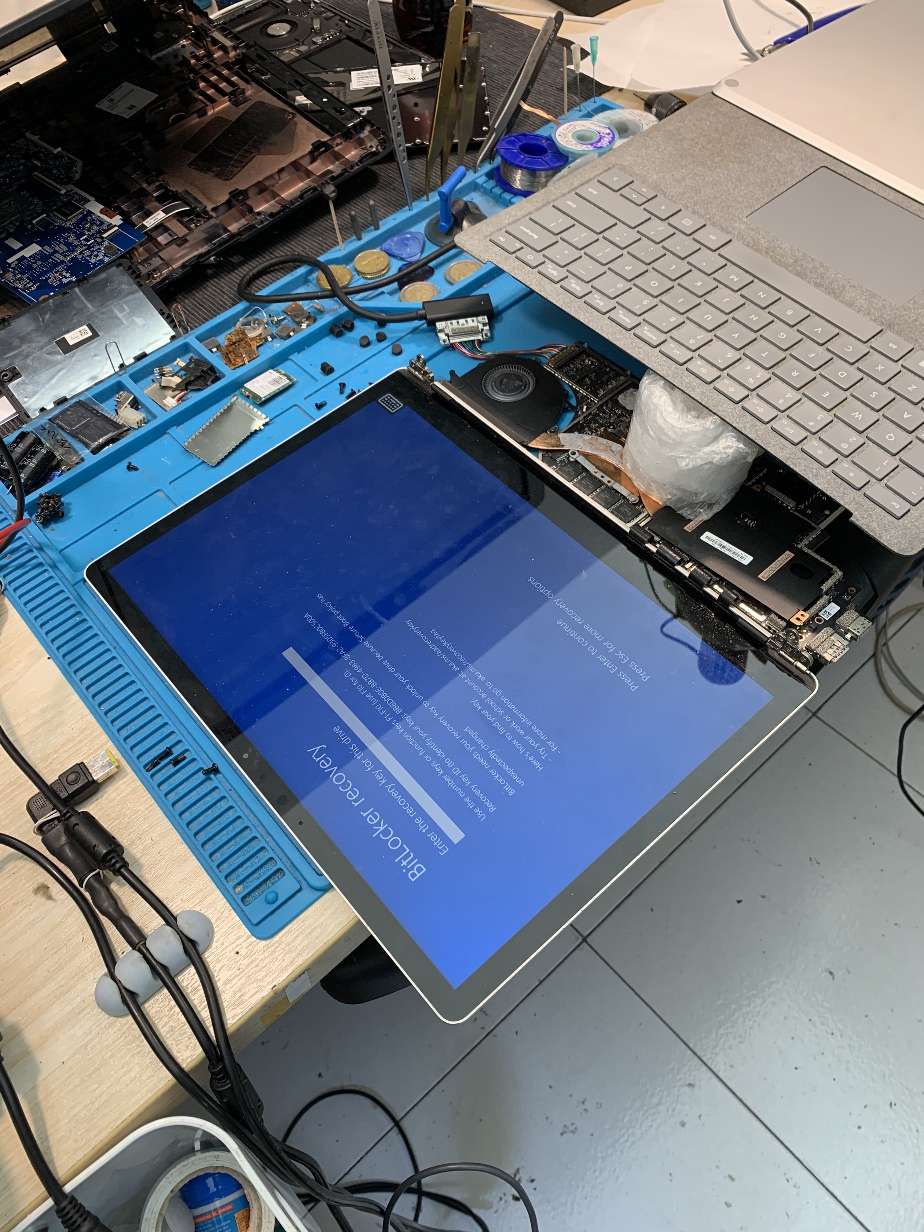

I think hardware have problem.can you please repair this bios laptop was showing startup logo and shutdown i tried another bios now startup logo stay for 10 to 12 second then it shutdown
please help me
thanks in advance
bitlocker is problem data HDD ( SSD)please clear ME of this one - it has bitlocker so we need the same file.
this bios is not working, but if I write different clear-me bios the laptop works but give message "bitlocker detected some change enter recovery key"bitlocker is problem data HDD ( SSD)
unrelated to BIOS
please guru clear me on this one - I need to try today or the customer will take the laptopplease clear ME of this one - it has bitlocker so we need the same file.
it is what ?"Error: Detected CSE Extension 0x03 with wrong Partition Hash at FTPR > FTPR.man!"
