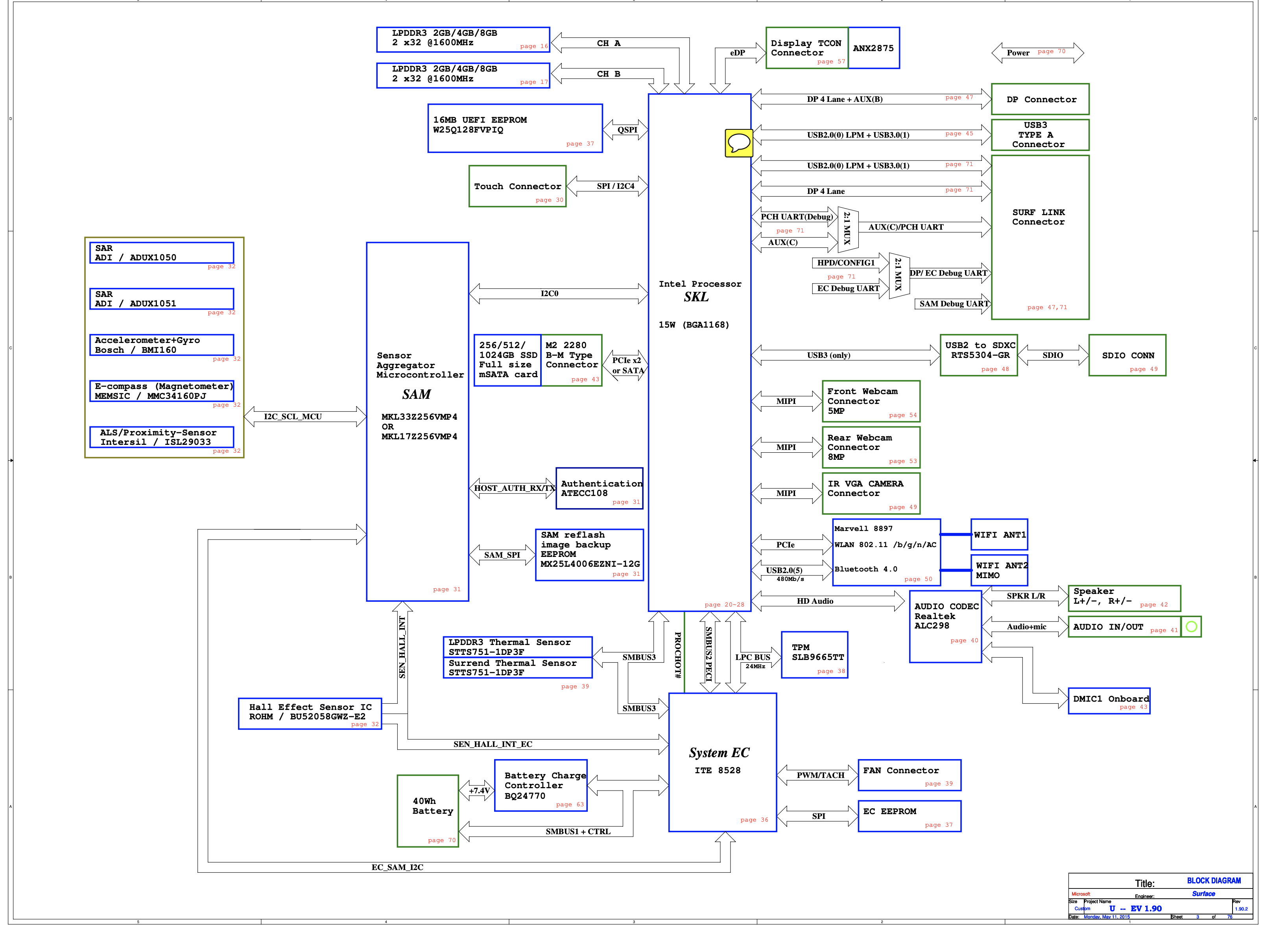

Schematics Surface pro4 X911788-009.pdf
X911788-008 REV1.pdf
A.pdf
B.pdf
X911788-008 REV2.pdf

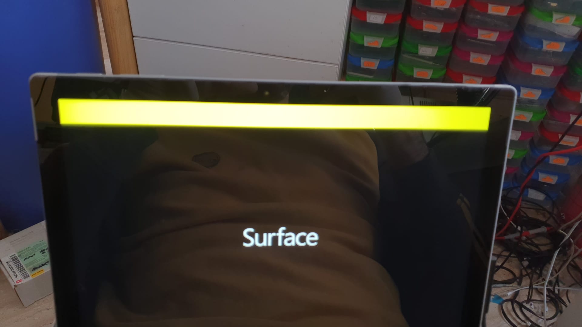

clear me is the bios no touch screen and when u shut down the surface the cooler is not stoping and backlight is on(after shut down the surface, the only waht to stop it is power buton) and the other bios is the original bios with no display

today i write the bios i have image on display now the touch screen is working great job but still problem with shut down(after i shut down the surface the cooler is infinite spining and backlight is on ) and second problem with this yellow line that appear only before he is enter in windows (this si a new one ) , i testet with old clear me bios and this line never appear is from the bios build11 , i wil atached a picture for you to understand thank you can u help?

that's all i can help next is your job

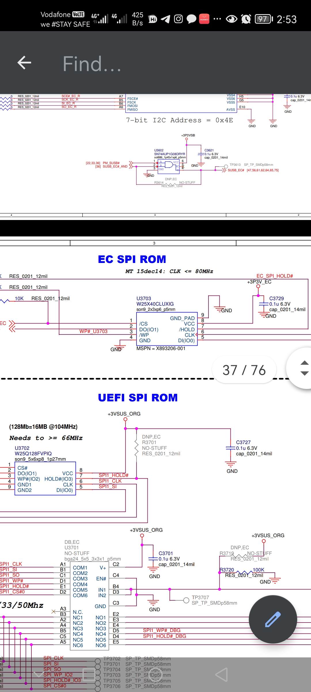

I will try to explain better my Surface Pro 4 problem, maybe you can do something if I explan better my problem
BIOS 2: Windows boot perfect and I see the Desktop. But I cant' do nothing. USBs and surface keyboard doesn't work , also touchscreen doesn't work.
I see all the data but I can't interact with the tablet. I don't find the way to save data.
BIOS 1: Windows ask for recovery key (that I haven't got) . The touchscreen works perfect. USBs and surface keyboard Doesn't work. (this is the original bios)
In this case the data recovery is really important, more than the tablet...
the SSD was accidentaly encrypted with bitlocker when using "BIOS 2" and actually the system only boot with this dump. Can you help me to get working the touchscreen with the original dump info? If I can get working the touchscreen I will have the posibility to decrypt the drive with screen keyboard. The usb's failure doesnt matter.
Only need to repair the part of touchscreen in "BIOS 2". If system detect significative different BIOS it will ask for bitlocker recovery.
