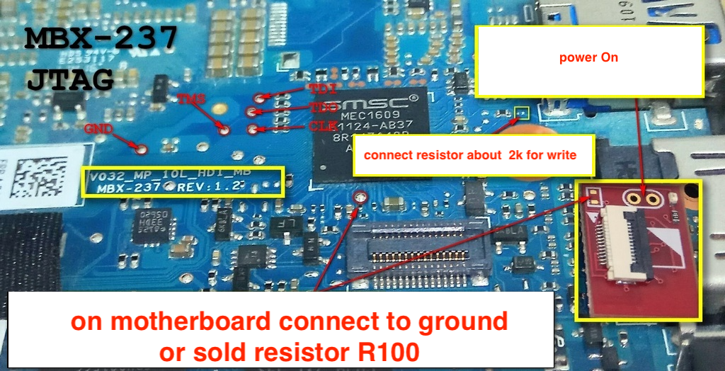

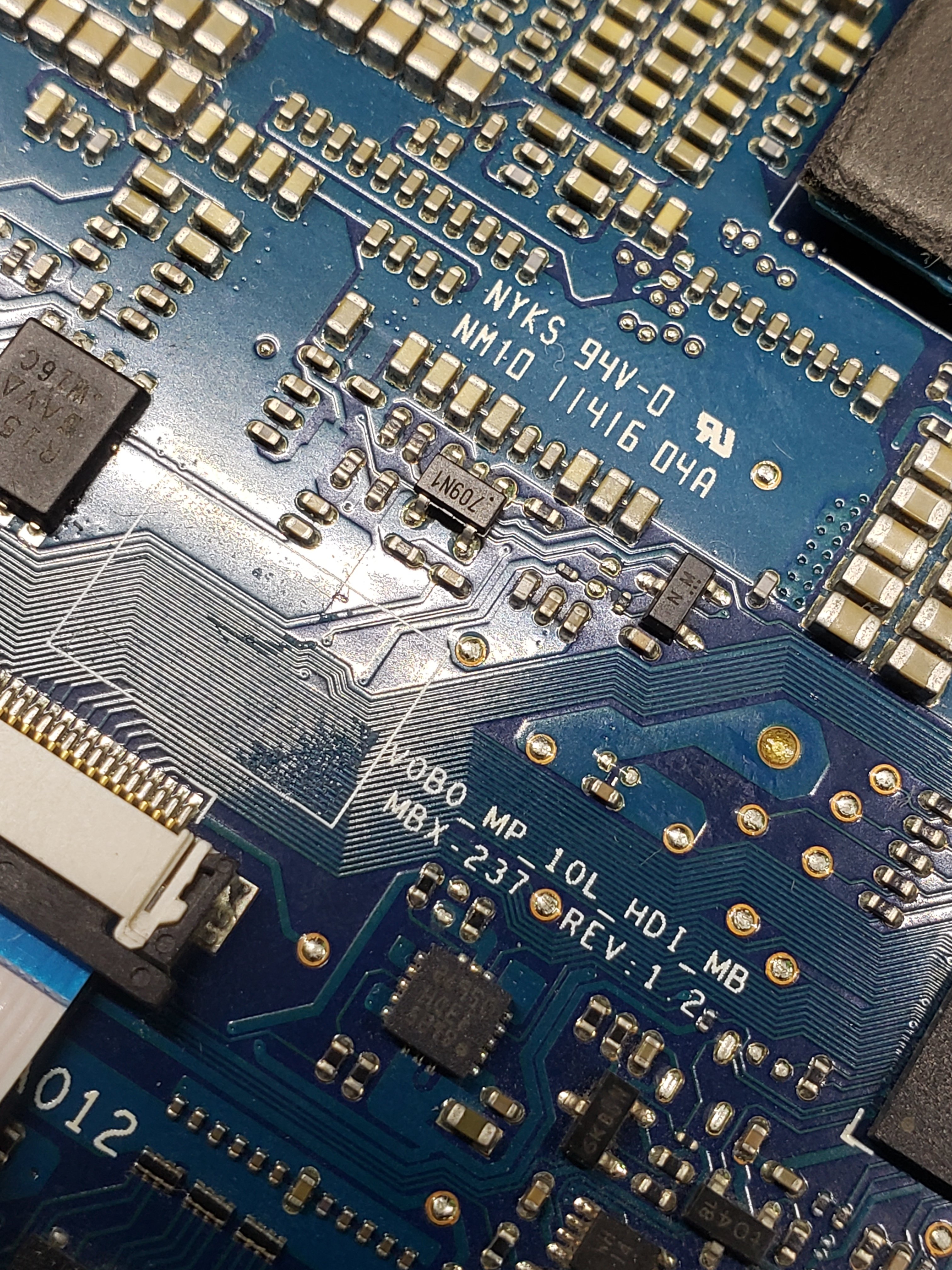

Foxconn V030 MP MBX-237 R1.3 0120 SONY VPCSB15GB
1p-0017701-a012
V030_MP_10L_HDI_MB MBX-237 REV;1.3 EC
V032_MP_10L_HDI_MB

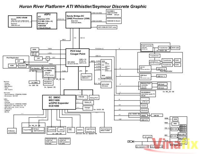

v030_sim_db_dvt_1014_1630.pdf
V030_FOUCTION_DB_MP_0120_1050_E.pdf
V030_DOCKING_DB_MP_0104__2030_F.pdf
V030_MSSD_DB_MP_0120_1021_ECR.pdf
MBX-237_v030.pdf
