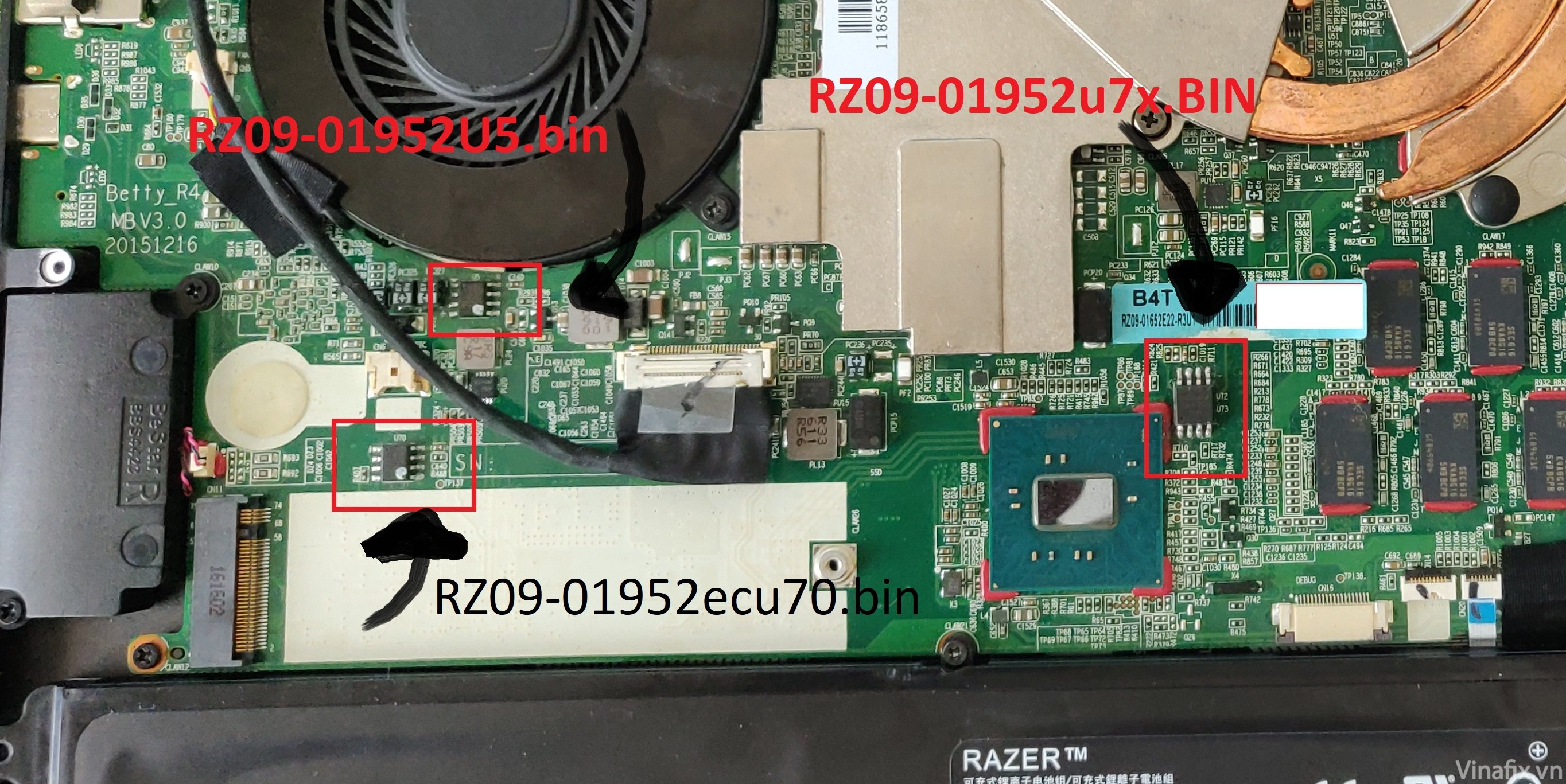

    Hi,
    Can anyone assist me with all the bins BIOS/ME for Razer Blade 2016 (6700HQ, 970m) RZ09-01652E22-R3U1
    Laptop is bricked. Someone please help
    Thanks,
    Hal

    RZ09-01652E22-R3U1?
    Or are you asking for the code written on the board? I believe that is Betty_r4 mb v3.0 20151216
    I will upload pictures of the board in a bit.

    Pictures of motherboard so that someone can help point out the chips where the 3 bins go
    The problem with laptop is it goes on, but nothing showing on screen. The screen is not faulty.

    does it mean you can't locate the 3 chip bios?
    send photo and BIOS old i check

    Here are the pictures.
    The red squares are the chips i can see. I need bin files for all of them as I believe I've now corrupted them. I believe the middle one is the 8MB Bios chip.
    The laptop went from switching on to completely dead after trying to flash the 128kb file you gave above.

    I flashed all 3 chips marked in red squares in this picture below with the bins you provided here :https://vinafix.com/threads/razer-rz09-0165e21-betty_r4-mb-v3-0.35779/
    Razer RZ09-0165e21 Betty_R4 MB V3.0
    vinafix.com
    Before I did this, the laptop was turning on with keyboard lights coming on but nothing on screen. After flash of bios above, its dead, does nothing.

    Are the 3 chips I highlighted in the picture the correct chips to flash with the 3 in the link?

    What I am asking is, based on your files, is this the correct chips to flash?

    check right size and right chip. This is a basic issue anyone needs to know
    and check each file one by one, you can't program all three chips at once so you won't know which chip is wrong

    I am doing it one by one. I'm asking if they the correct chips. Or are there other chips on the board?
