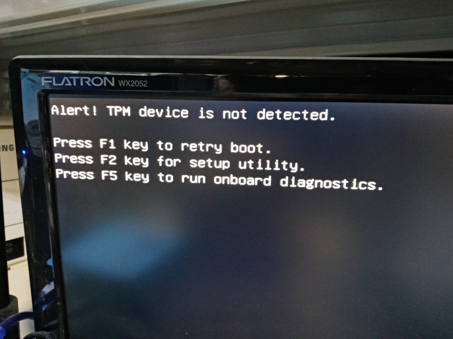

builds1.zipthis bios no display repair this bios urgent
late display
cls.zipClear Me.
Alert! TPM device is not detected
TPM need buy patch 30$Alert! TPM device is not detected
Service tag is different.
Clear Me again.
Clear Me to my file.
I just help clearmeno screen, no boot
Bad boot bios.
Correction please.
how is right bios ? you can guide me ??The bios you sent is Power off
Correction please.
if all bios doesn't work then you need to check the hardware i have nothing to helpThe power is turned on automatically when the power cable is connected.
BIOS waveforms are recognized, even graphics.
No screen on the monitor.
The cls file you sent before will boot.if all bios doesn't work then you need to check the hardware i have nothing to help
builds and clearme I helped you above
