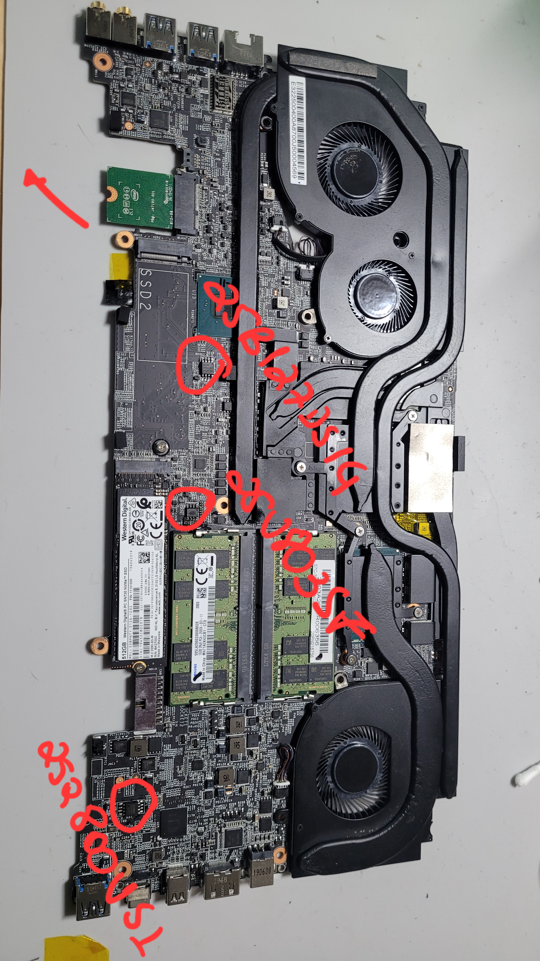

I have exacltly this model on topic but I cannot find the second BIOS chip, the bigger one, MX25L12873F which is supposed to receive the bigger BIOS file. Can you give me a help for that? Thanks. Ed

on top have two bios
16MB for chip MX25L12873F
file 128kb for chip ENE ( I/O)

I'm sending you a picture of the board, where I pointed 3 ROMS I found. None is the mx25L12873f. My recorder found the cops exactly with their name printed on the chip, so, I guess it's not a mistake of the software... I really appreciate if you could guide me this chip location... This board has a password lock and it's running Ubuntu. If there's any other way to clear this password, by software for example, maybe help s as well...
Thank you for your patience. I really appreciate your time.

only care one main BIOS 16mb

This mainboard has 3 flash chips.
1. BIOS
2. GPU firmware
3. USB firmware
The EC firmware (128kb) is inside the ENE chip !
